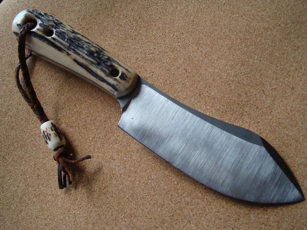

Such alluring silhouettes of eye-piercing beauty that i finally succumbed myself of wanting one and out the lurking cocoon i broke out to find Kalel (er...he still wearing his inside, i believe) AKA Hunter Martin's design on this very thread:
http://www.bladeforums.com/forums/s...-Jim-Rosa-M390-Nessie-with-Culry-Mango-scales
Magical, innit?:D
Not to derail from the monster that Jim is making, i must give credit to Hunter Martin who actually designed the Nessmuk above and had Jim made it for him.

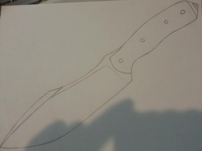

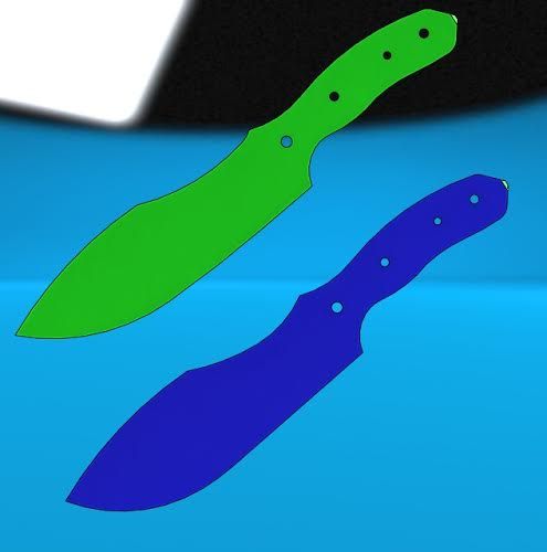

Concurrently, Jim and I have been sketching out some outlines on the Monster:
P.S: The upper left is the actual stock of Hunter's design and the lower one is what Jim had come out with.

Now Jim added a new rendition, this time without the spear tip and more stream-lined. Notice that the pommel has a skull-crusher.

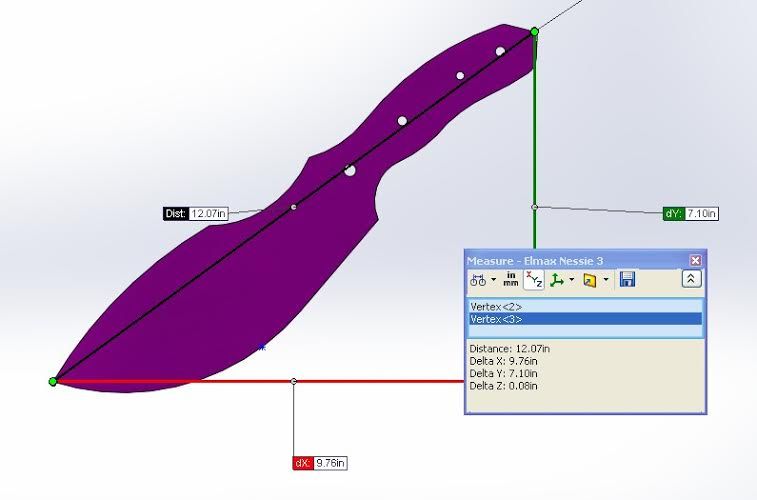

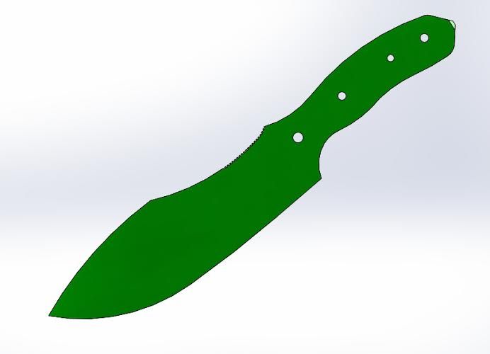

After Jim's sketches, i put the perspective into CAD file and drawn out the profile:

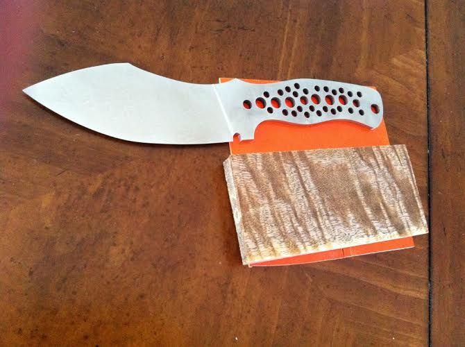

One can never be too convinced what's behind the computer hence a physical model is ever-ready:

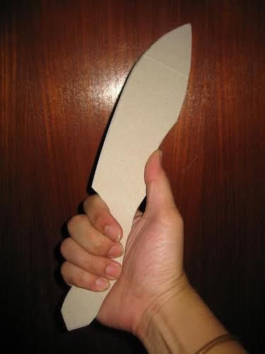

I printed a 1:1 scale model of the part,attached it to a cardboard and drew lines around it. Have it cut out for the feel.

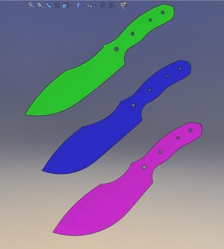

Hm....let's go crazy a little bit?
Great write-up Jay. Looking forward to seeing more progress photos. I like that last (purple) design in your last photo. Something about the angle of the edge to the handle appeals to me more on that one.

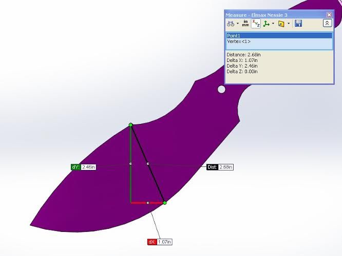

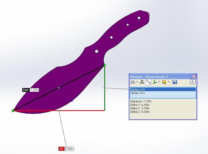

I like my knives with a bit of belly for that extra cutting so i went the purple version and here are some dimensions i measured on CAD:
That's about 2.68" on the belly for a 12" knife.

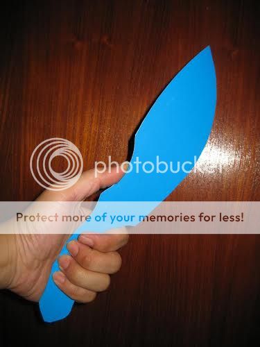

My intent is to have a compact blade that handle hot yet humid weather here and delivers all camp/trail job easily.
I repeated the same steps and cut out the profile itself. It felt alright on almost all grips:

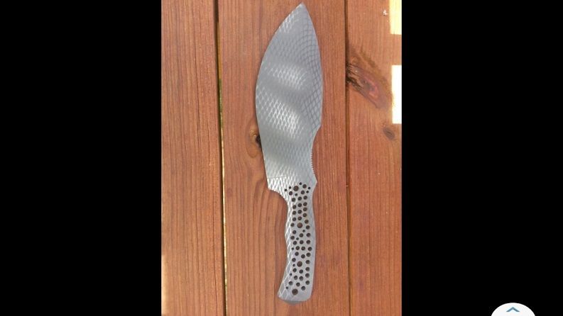

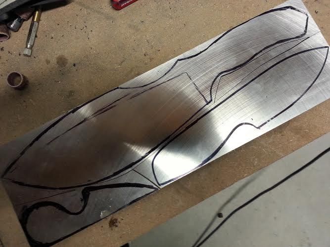

So as months passed i have forgotten about the blade. Jim is a very busy person but when you least expect it, he popped out with surprise:

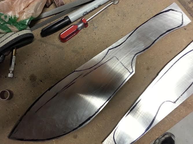

0.198" thick Elmax stock for the big boy, a Kephardt (The very same profile of my Vanax) and a small blade, ready to be cut.
Things getting excited as the silhouette of the blade is floating out from 2D into 3D.
Sexy, isn't it?
Jim managed to send me some WIP pics despite his insane working hours!

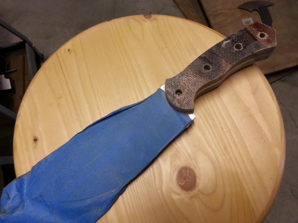

A semi-naked Nessmuk,with a layer of Cerakote.
We chose burlap micarta over G-10 to give the entire a rather savage yet sleek feel.

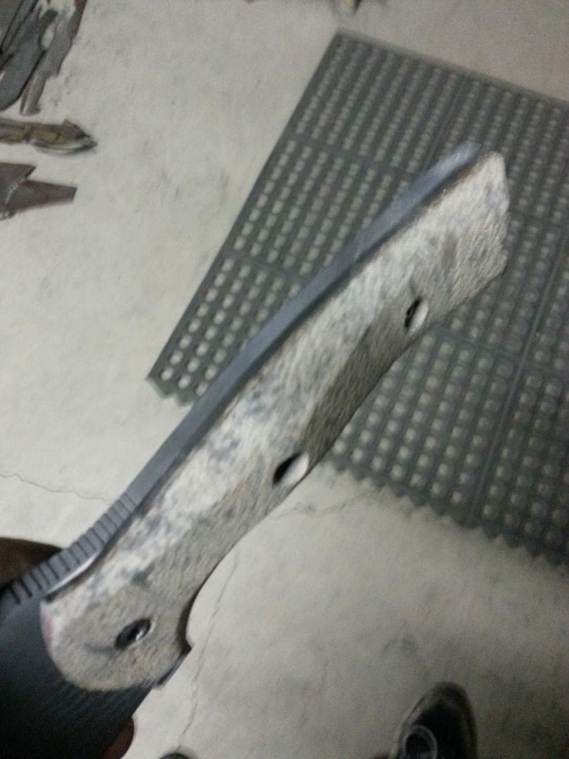

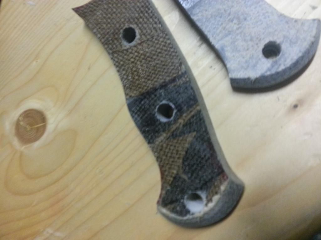

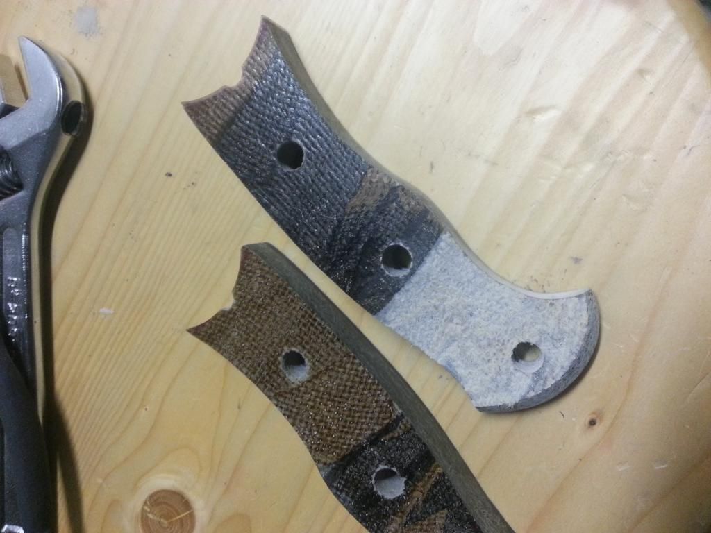

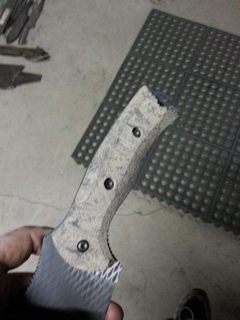

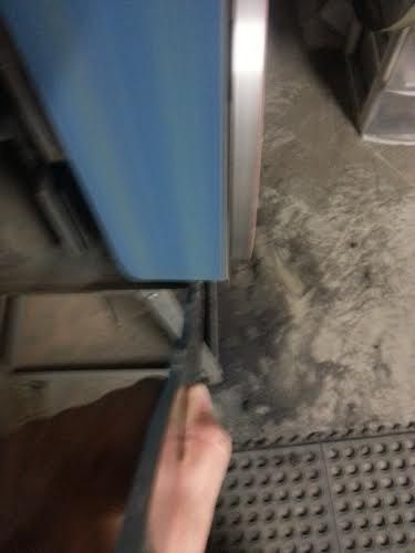

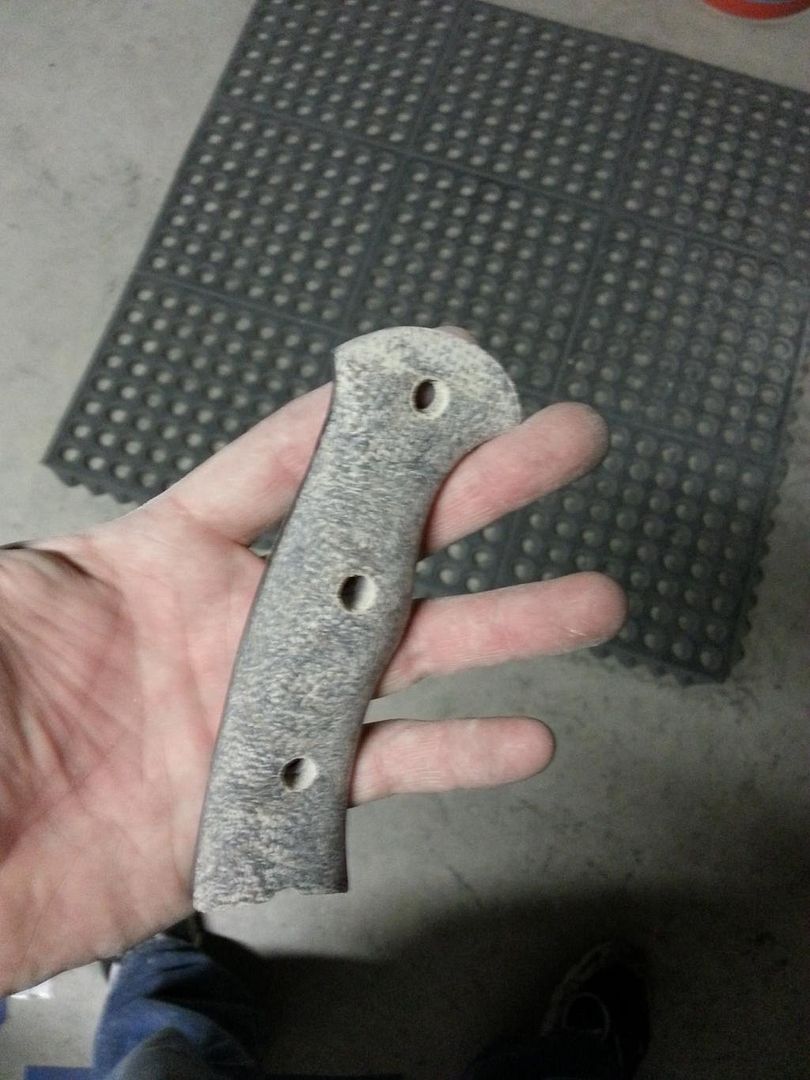

Here are some of the pictures from Jim on how he put the jigsaws together:
The virgin piece:
Went under the belt a bit:

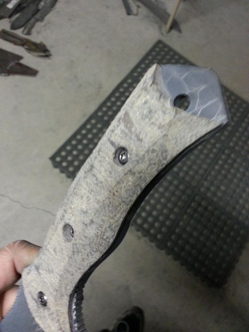

Top view on the roughly scalloped scale, after a 45 deg run:
**Yes, there is a liner stacked next to the burlap for those with sharp eyes, which Jim commented i need not to have my vision checked:D
Notice the end of the burlap was machined to allow relief for the pommel as well as lanyard.
MORPHEUS!:
