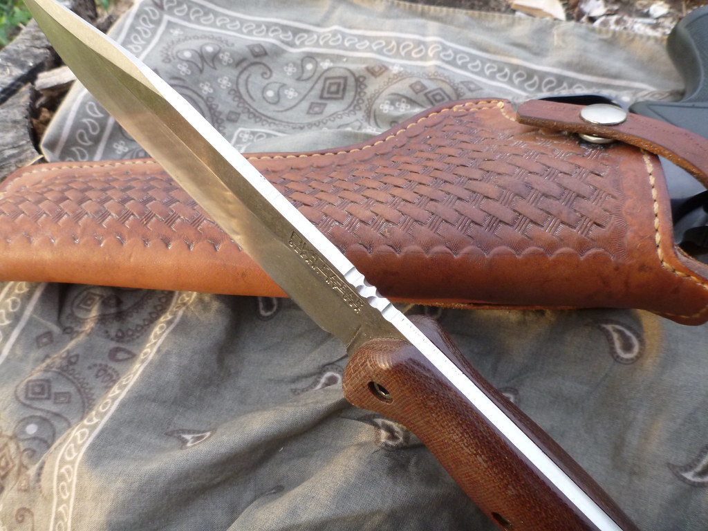

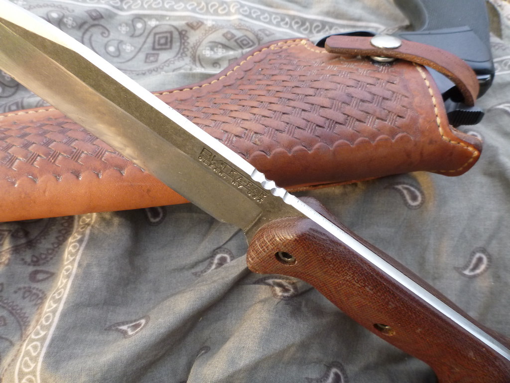

Did a little "fancy" filework jimping to dress up my sexy seven today. I just didn't like the single groove left after de-ramping her.

Did you polish that micarta? Don't really see that too often.
What causes there to be a single groove after de-ramping it? I have seen people mention it before, and always wondered.

The groove closest to the handle is behind the ramp and so filing it flat leaves the proximal groove.

There is one groove at the base of ramp that is below the spine line. It's left when you grind the ramp flush. Same with the nine.
I just put some Tru-Oil on the micarta right after I got it to keep it clean. It's held up up pretty good.
This makes me want a 7 just so I can do it...might have to practice on the "other" 9. Great work and thanks for sharing!
Very nice, I've been thinking about trying a vine pattern on my 9 but I like the look of your jimping too. What files did you use?

I just had a couple of chainsaw files in the drawer. Not sure what size they were.
