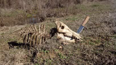

I did not have a chance to clean a hog with the Viktim which was my main goal of the review; however, I did try a little Texas bush-craft by battoning and whittling. I chose an old aged piece of live oak as a baton and to split. The knife worked great and I appreciated the 5” length. The photos show I had the blade in a small bind once, but it bounced back to form. Overall, with my very limited baton experience, this knife worked well for my needs. My needs being only to baton this size knife in a SHTF situation, which I hope to never need. I then went to town on a few finger size cedar that I would use for bedding or to clear a shooting lane. The knife worked well, with 10 “chopping” hits at the base and the branches peeled away. I then moved onto splitting old dead cedar, which I believe a much more practical method to finding dry tinder for a fire. The cedar was so old and brittle, little to no twisting was required to break the wood into tinder size pieces. I tried wrist size mesquites as well and had no issue with pushing the blade 1” into the wood and twisting to break it apart.
I did shoot a hog later in the week and had a chance see if it cut well against the hogs hide as evident in the photos. The fact is I never clean a boar this size, they taste terrible and considering the weather (raining in the dark) and being by myself with no method to pick him up, this boar is destined to become coyote bait. I judge a knife’s sharpness in a number of ways; one is how easily it will cut through the hide of a hog. A second is my rope test. I place a length of 5/8 poly rope from Depot in a vise, pull tight and if the blade cuts the rope in half with a single pull from the blade then I consider it sharp. Lastly, if it will shave arm hair, I consider it sharp. The Viktim was that sharp before I left for the ranch.
Although I had run the blade through battoning the 5”oak, splitting 4 wrist size pieces of mesquite and cedar, chopping 3 thumb size limbs, scrapping a quarter size pile of magnesium shavings, stripping 2 ends of 12/2 wire and prying the rope lose from the hitch the blade did not cut the hide easily. In fact the large cut on the belly took at least 10 strong pulls against the hide. The small cut made by my freshly sharpened RS took one. (shorter cut in the pic). Once the hide was pierced the Viktim did cut on average with other blades I have used.
I will say this, when the knife was fresh from the grinder I did have an opportunity to remove the old hide at the base of the tusk of a hog I shot this winter. Check the photos of the remains of a 250lb boar shot in December. The blade performed very well, slicing right through the old dried hide and scraped heavily against the skull. I did not notice any edge loss after this effort at that time. Even before I went to cutting this live hog, I felt the edge was sharp enough to cut my finger if I ran along it. I knew it was not a fresh edge, I just thought I had not dulled that portion of the edge as 90% of cuts were close to the handle. I assume the chopping motion on the cedar and mesquite, about 50 total hits, dulled the edge. As I have not really chopped before I am unfamiliar with the ability of an edge to stay sharp after this type of use. I know the Viktim had been through a full day worth of work, however, I expected more from O1 steel. This may also be attributed to my lack of sharpening ability. Remember I am not an expert so the edge may not have been perfect to begin with.
