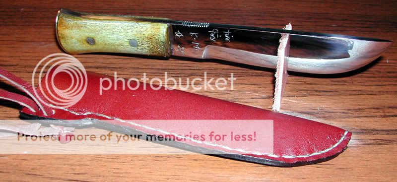

Jeb, I got mine today and love it. The handle is small, a 3 finger grip for my small hands. Filed thumb grooves, convexed the edge, stained the antler just a tad, put some Edgecote on the bare edges of the sheath. Sweet little knife
! :) A poorly lit picture is attached.
Steve
Nice Job Steve.:)
For staining antler or bone to look really old; soak it in an instant tea with lemon added. The citric acid of the lemon helps the tea to penetrate the bone especially as it's usually not as porous as antler.
Depending on the porosity depends on how long you leave it in, dosn't take long on some projects.
Also the stronger the tea is will, of course, make a difference in how long it needs to soak.;)
Heating it up and rubbing it with hot vegetable oil will sometimes give it that beautiful translucent color in places that I like so much.:D
