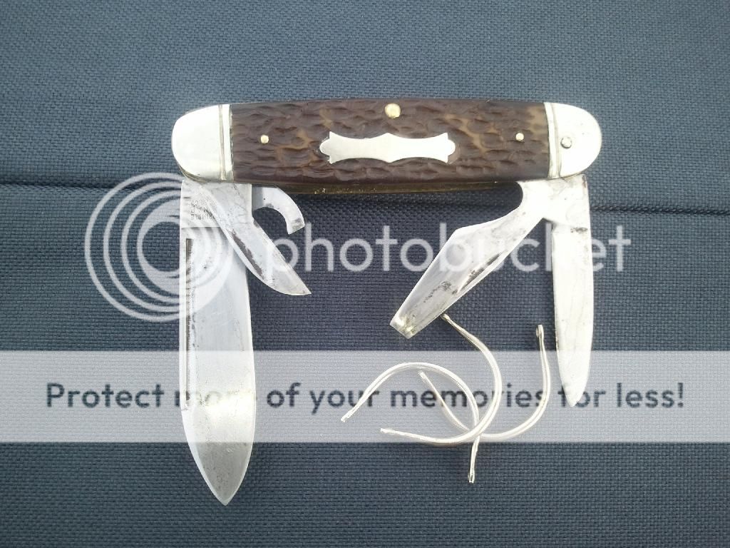

Well fellers, i will get right to it.

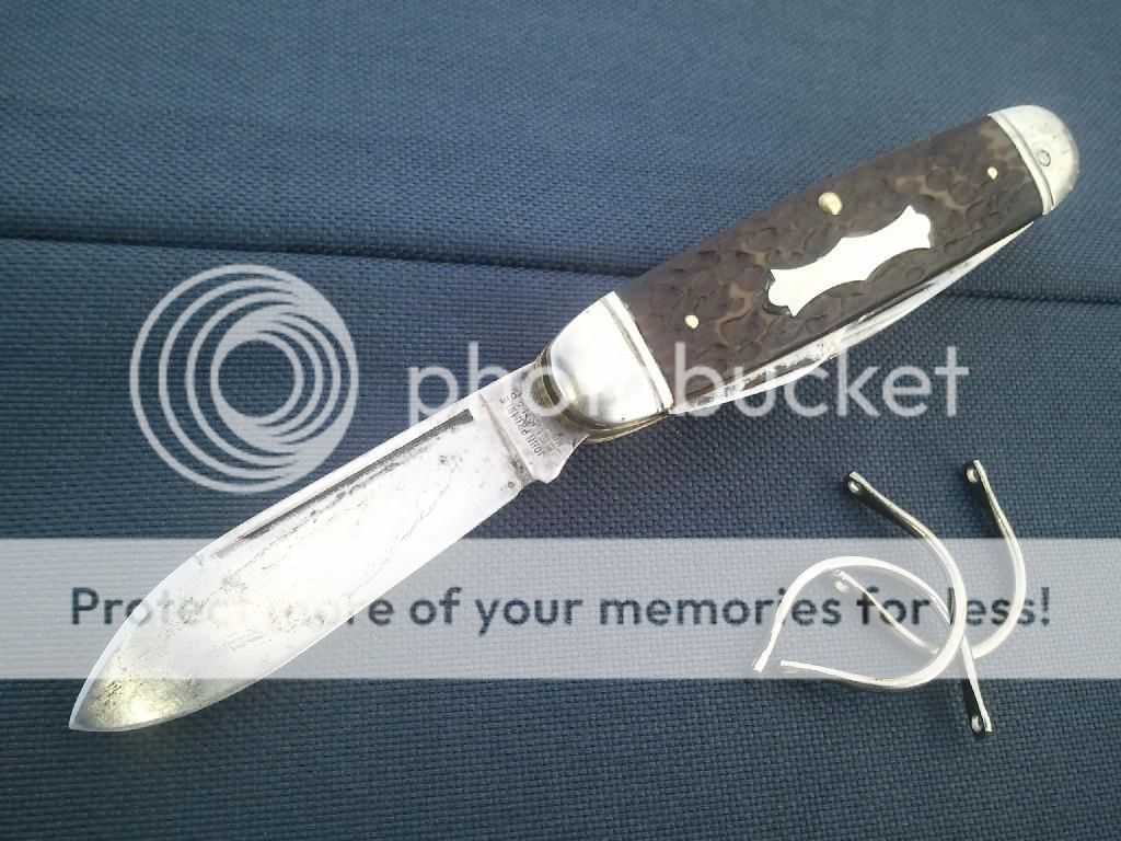

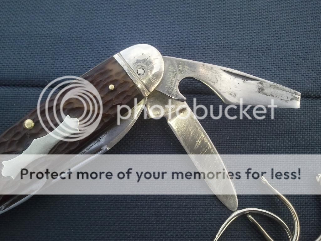

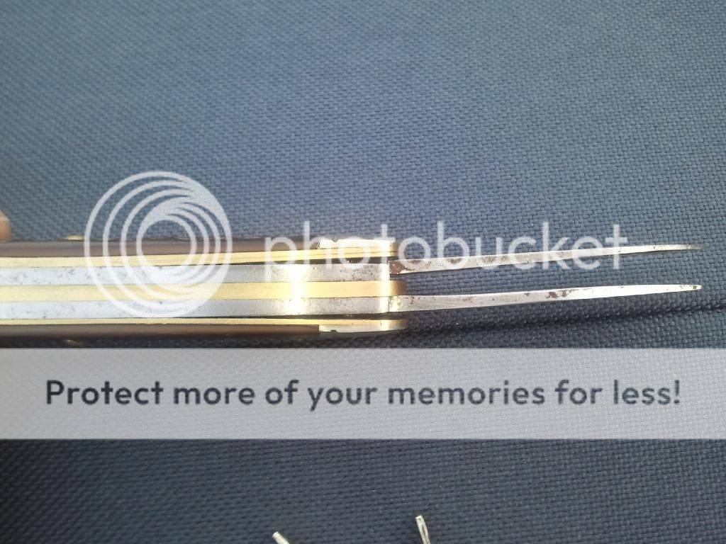

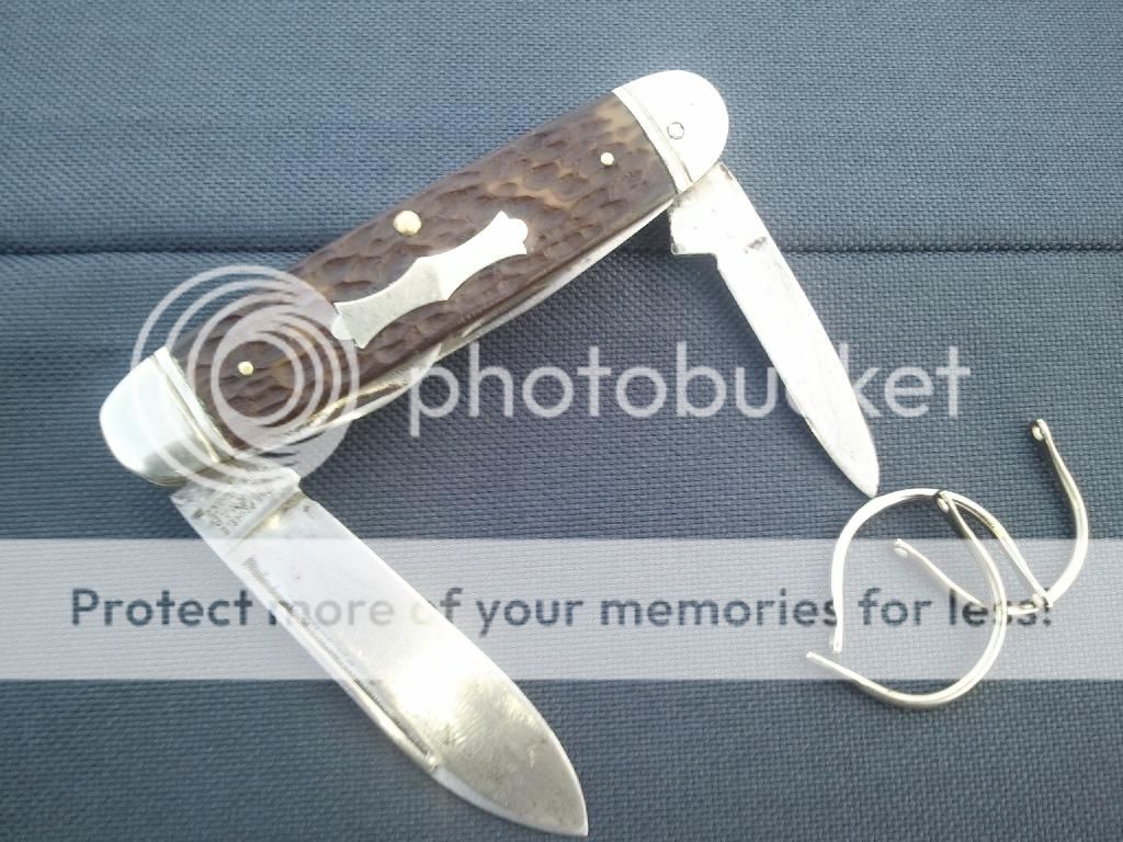

I have had this John Primble camp knife for as long as i can remember but never used or carried it because the bail and pin had been ground off and the knife is falling apart.
Here is what i am talking about
It has nice covers and the blades are mostly full

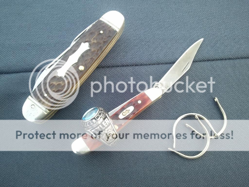

I even bought some lanyard bails
With my peanut and class ring
it is a nice knife. I would love to have it ready take on my daily knife chores, but the pen blade and bottle opener are unusable.
Does anyone have any ideas on how to fix it?
I think it would need a new pin and then put the bail on.
I would really like make this knife a user, it seems perfect.
I have never tried to replace a pin in a knife and don't know how hark it would be or if i could even do it.
I want to get 'er fixed up though.
