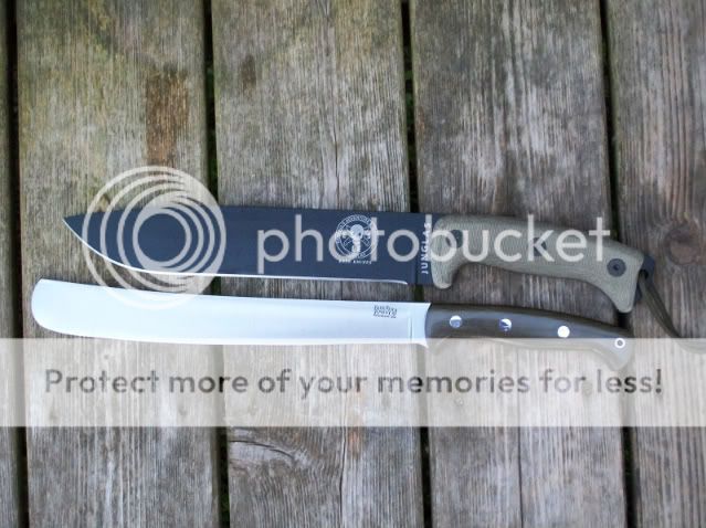

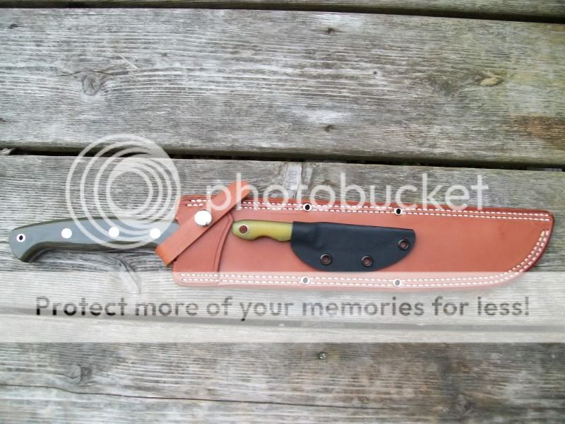

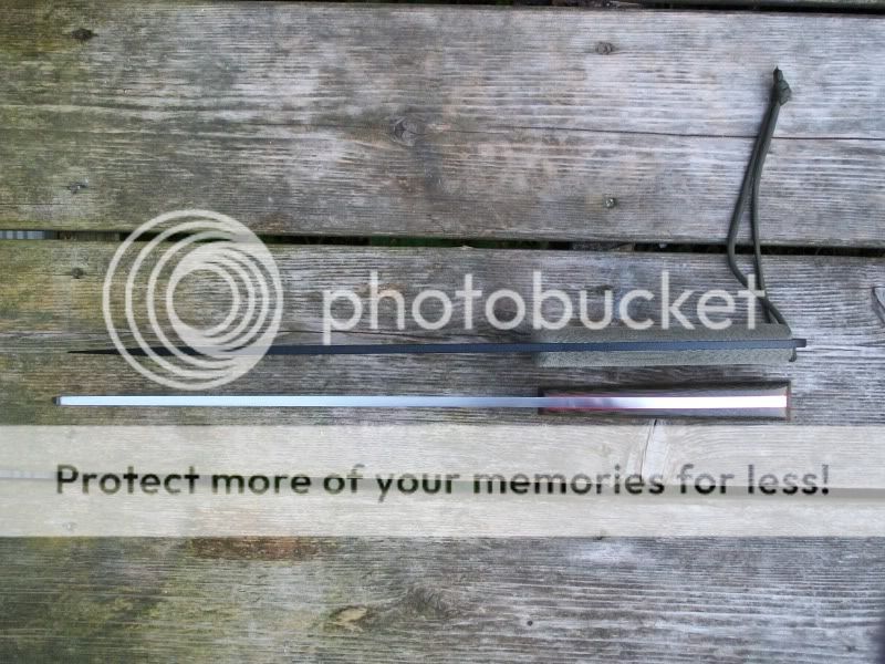

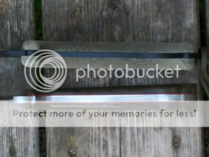

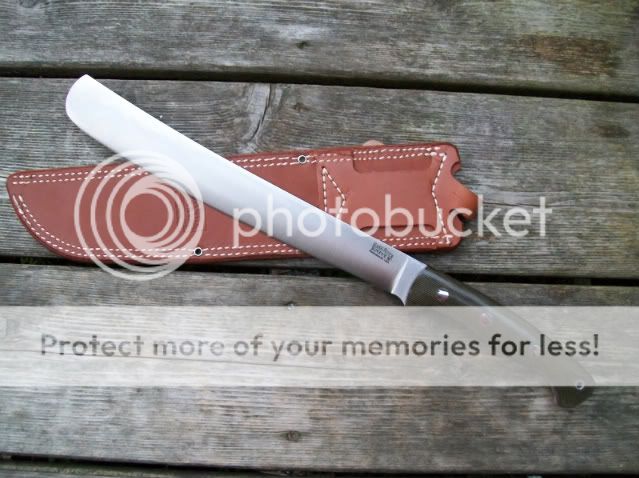

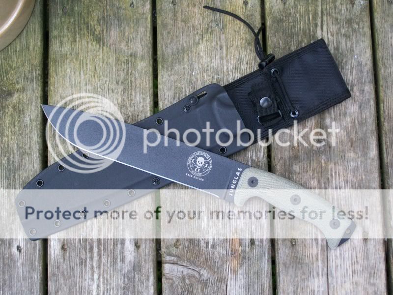

I have both and in fact just did a comparison chop-off with them last week. They both performed about the same. Despite being the same weight (22 oz.), I'd say the Golok is much quicker in the hand. The fact that it has a much thinner handle than the Junglas might have something to do with my perception of that, as I prefer thinner handles. But that's not to say the Junglas' handle is thick and unwieldly; it does feel nice in its own right. The Junglas definitely has a tougher v-edge than the Golok's very thin (and as I found out the other day on a coconut... hey, I just tapped it) delicate convex grind edge. The sheath for both are nice, but the Junglas' kydex/molle back is super-versatile and convenient, whereas the Golok's leather Sharpshooter sheath is standard an simple. I don't have alot of experience with 1095 yet so I can't really comment on it (other than so far so good), but I have had rust/oxidation issues with the 1080... not actually on the Golok but on the Bark River Camp Axe that uses the same steel. I can get both steels crazy sharp, and they held great edges during the chopping I've put them through. Not sure what else to say, other than the usual BladeForums refrain: GET BOTH!:D They are really both fantastic knives. I fully intend on picking up future editions of the Golok as/if they come out in different steels. I'm sorry I missed out on the A2 version awhile back. Here's some pics for you guys.
I like 'em both
