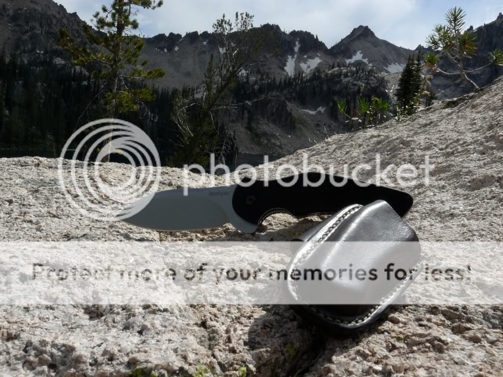

Been comtemplating a composite JYD and reading this post along with the pic of that sheath is about to push me over the edge.
