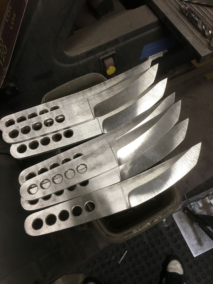

Working on a couple Joe P Kraikens, figured I'd post up some pics as I go. Most of these are spoken for. :cool:
These are all CPM 3V and chisel ground.
So I managed to get all of them HT'd and Cryoed yesterday. Here are a few pics.....
All wrapped up in foil.
Out of the oven being plate quenched
Out of the foil, nice and clean!
Everybody in the pool!
After the Cryo bath..
More pics tomorrow!

That Wilton vise came out of my grandpas old cabinet shop. It is bomb proof and really cool being able to use it in my shop. Works awesome for plate quenching.
Here is one of them with the flats cleaned up and the swedge ground in.
Finish ground and making my mark.
Ready to wrap!
