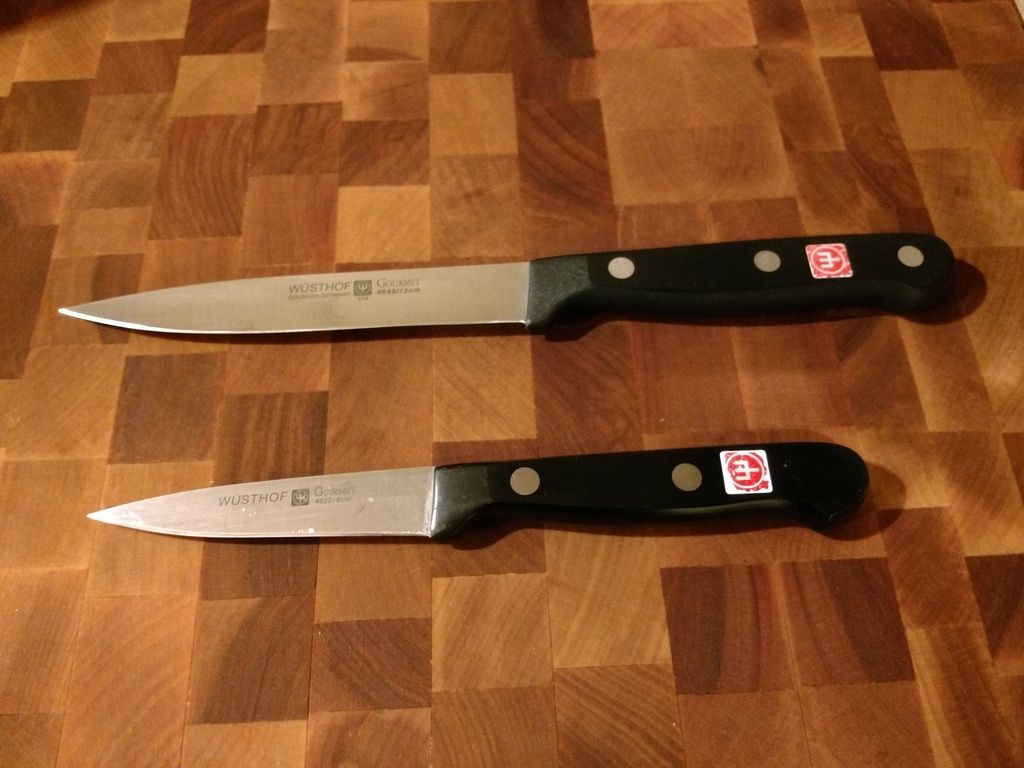

I've done a lot of chickens and a lot of smaller deboning jobs like legs and breasts and for many years I've used a Wusthof Gourmet 6" utility knife. For those not familiar, the gourmet line is their budget line and is...gasp...hand wring...STAMPED steel at...shudder...an advertised 55-57HRC. And, it isn't even a boning knife. But, I've found for poultry, a lot of the work is done by the belly and the tip so it is close enough to a traditional boning knife that it works.
Now, for the tendons on the turkey legs, I reached for the pairing knife. I wanted to keep the utility knife sharp but still have focused control. Remember, cold, slimy hands. I'd tuned the utility up on a black Arkansas before the task and it was plenty sharp but I hadn't touched the pairing knife in a while. It last saw a soft Arkansas stone and then light stropping since.
Getting through the joints, scraping down the bones and severing those tendons are no BS work. For the majority of home users, this is putting the blades and edges to the test.

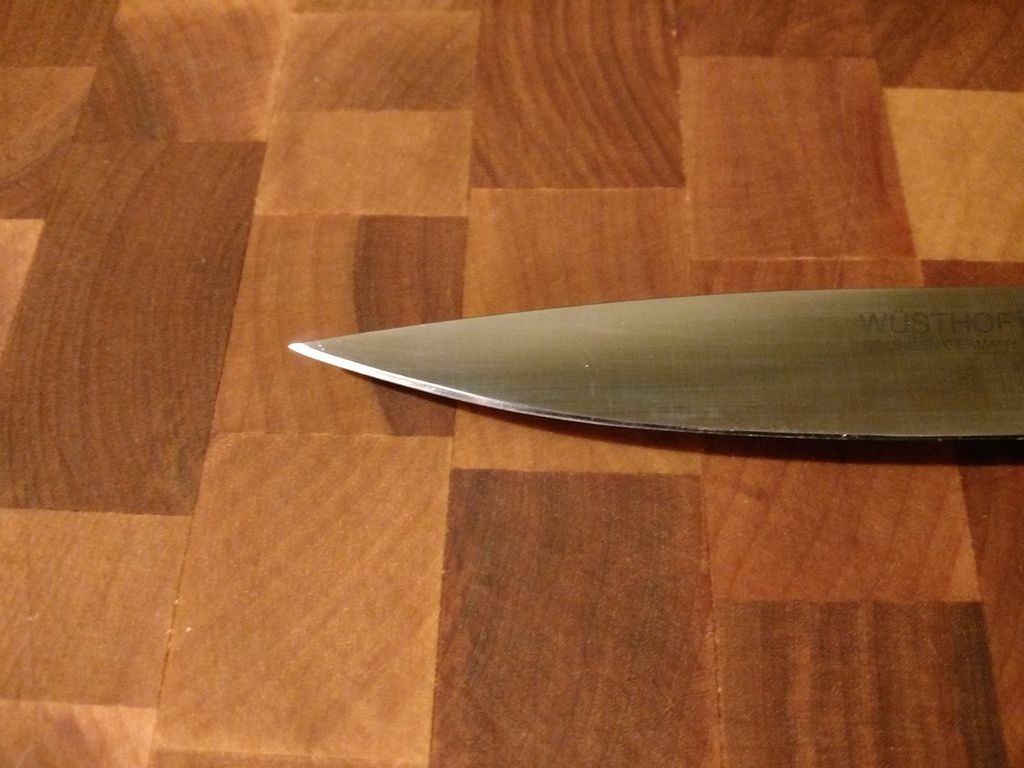

And they held up beautifully! I just checked and both knives will still shave arm hair along their belly's and flats, although the pairing knife was pulling which is no surprise. There's no rolling or chipping and really "reasonable" dulling. I'd expect that if I was to do another bird without any touch-ups to the blades, they'd show signs of edge degradation.
Now, this is, as always, highly subjective and relevant to specific discussions, but for me, this is just an example of wonderfully thin edge geometry married to adequate steel production and introduced to proper edge treatment to excel at a given task.
