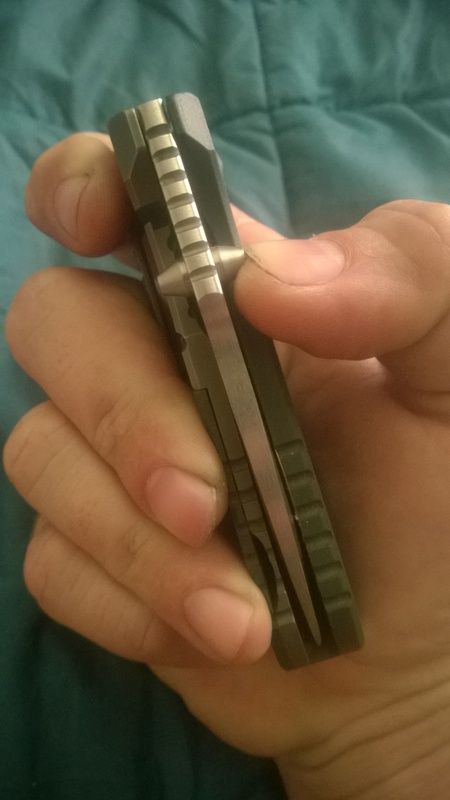

Hey guys, I can't open my MPR using the thumb stud... if I use my left hand I can get it open. Any suggestions? It's just too hard to open.

I had problems with mine...until I made sure to keep my fingers off the lockbar while opening. I hold it like this and have no problems flicking it.
~Chip
Unfortunately, I've tried every right hand placement and it makes no difference. Thanks though.
cchu518 means that for the heavy thick blade to stay closed they put a larger detent ball into the lock bar. This means it's harder to open up, but stays closed despite the chunky blade. I think most people prefer heavier detent on heavy blades.
