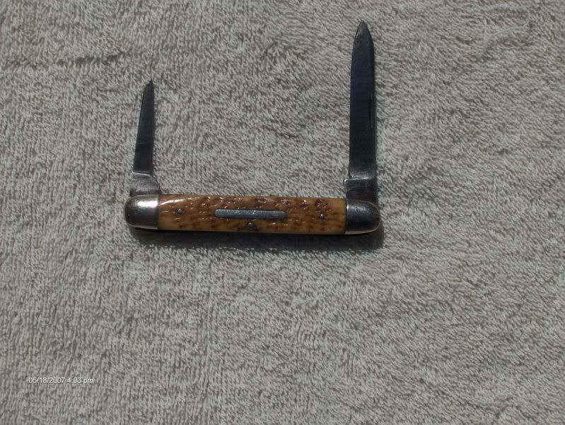

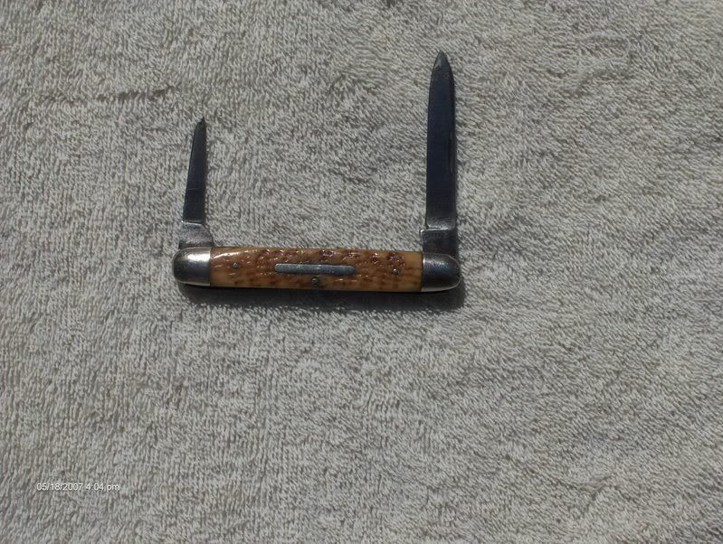

Mostly collect Schrades but saw an older Camillus in great condition, so decided to pick it up. I can't get a pic of the tang stamp but here are pics of the knife:
The tang stamp says:
CAMILLUS (in a half-moon shape) with a line underneath it. Then under the line, it says CUTLERY CO. And then NEW YORK underneath that. The seller says the knife is from 1902. My question: how do you know exactly which year it was produced? I paid $85 for it, so don't know if I got ripped off or not.
Thanks!
I seriously doubt anyone can tell the exact year these were made. John Goins said in his last book that the curved stamps were used circa 1902 - 1918. A copy of a letter I recently received which was written by a fifty year employee (and likely was there at the beginning, or not long after) stated that there was no real emphasis placed upon maintaining or changing the tang stamps, they were quite simply used until they were used up. By this, I take it that several different style stamped blades might be found in the factory at any one time. An estimation of "circa" or "Post-" or Pre-" is usually the best one can hope for. The same was true of Schrade Walden being changed to Schrade Cutlery in early 1973. While advertising, letterheads and catalog logos might change with a rough date, the tang stampings did not. If we take Goins as our best authority (he is often in error), your knife is likely pre-WWI. Perhaps CAMCO can clarify.
Codger
Thanks Codger. For what I paid for it, I think it's worth it and man, this knife has incredible walk and talk for it's age.
I like it. You just can't beat old pocket worn bone (not CASE) and good tempered carbon steel. That knife has a charactor of it's own as is. I'll see if I can get the letter transcribed tonight. It is difficult to read as is (handwritten ... or I would post it as-is), but makes some excellent points about Camillus tang stamps worth sharing.

That is a nice old knife Marc! :thumbup:
Great find!
I agree with Codger, that old worn bone has a unique & pleasant feel in the hand!
Dale
