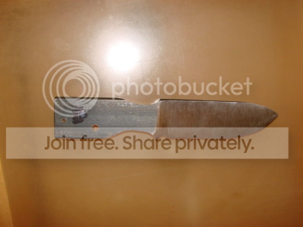

Okay. I'm running into a bit of a problem here. The stock I am working with is 1/4" thick from McMaster Carr. I assume it is a tough spring temper, because it is easily cut with a file, and grinds nicely, but is hard enough to damage some tools. After I drilled one hole with no issues before starting to grind, when working on the second hole after some roughing it destroyed a titanium nitride coated 9/64" bit after I drilled a smaller pilot hole with no issue.
I've only worked with various stainless and some 1095 before(all rather thinner than 1/4") and never had a problem using TiN coated HSS bits. Should I buy a bunch of cobalt screw machine drill bits for working with steels like this (probably spring-temper) 5160? Perhaps should I get TiN coated cobalt bits, even?
Here's a picture of the piece as it is now, for the curious:
All I've done so far is hogging, no finish work at all yet.
What are you using to drill with. Spring steel requires a much slower speed than most realize. 1000rpm might be too fast for some of these steels. A good rigid drill press is a must to make the TIAN drill bits worth the difference in price. IF you are using a hand drill go a slow as possible and use a cutting oil. If you can cut it with a file you can drill it at the proper speed. Good luck and keep on grinding.
I was using a Buffalo drill press with the belt on the 800 RPM pulleys, and was using a sulfur cutting oil. The other speeds available are 1500 RPM and 3000 RPM, which I thought would be too fast, and you seem to agree on.

Try removing the mill scale before drilling, your drills will thank you.
I soak the steel in ferric chloride for about 30 minutes then use a wire brush to remove scale. Vinegar works too, but is slower/longer soak. Scale will not only ruin files, drill bits, and hacksaw blades, but will even ruin ceramic grinding belts in short order.

I have had this problem when working with 5160 too. The steel was 5160H purchased from two seperate sources. One hole would drill just as annealed steel should and another would dull the bit and scream like the steel was not fully annealed. When I messed up a couple band saw blades I started cutting my stock with a cutoff saw and re-annealed the pieces before proceeding any further. Since I have been doing this I have had no problems.
Always remove the scale from 5160, I have found hairline fractures in 5160 that were not noticable with the mill scale on. At first I thought this was just a bad batch from the mill but after doing some research on the web I found where others have noticed the same using 5160.
