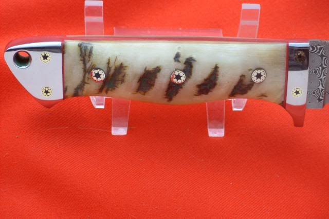

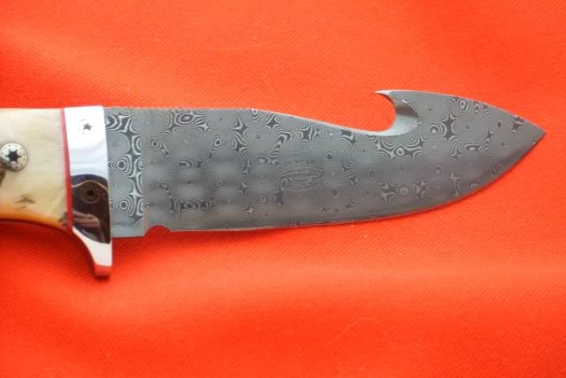

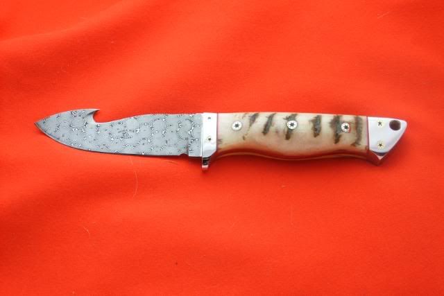

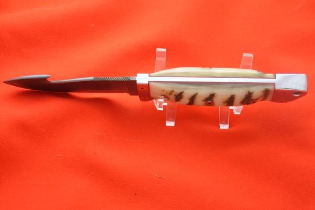

Finished this one yesterday and have delivered it to the customer. The handle is somewhat larger than I normally make but it was fit to the customer and he has very large hands.
Steel: 1/8" Devin Thomas Stainless Damascus
Blade: Length-4 3/8"(tip to guard) Width_ 1 1/4",Flat Ground,Hand Rubbed to 600 Grit before etch,Checkering on Spine for thumb.
Overall Length: 9 3/4"
Guard and Bolsters: 416SS with Mosiac Pins
Handle: Corsican Ram(I shot the Ram at the YO Ranch in Texas), Red Spacers and Mosiac Pins.
Thank you for looking and all comments are welcome
