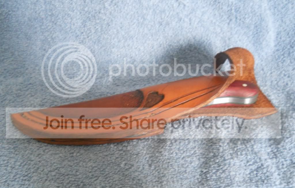

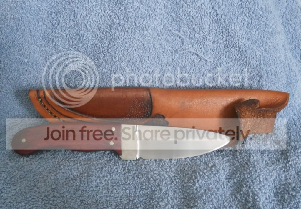

On a bit of a roll here. This is on I made for my wife and have been draging my feet in finishing. it's 7.5 inches OAL with a 4" BL steel Is 3/8" 440c hollow ground on a 10"wheel. full length swedge also ground on the 10" wheel. handles are purpleheart with green and purple liners and stainless pins. 3 coats of tung oil sanded to 600 grit between coats.

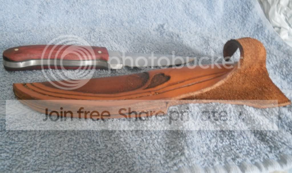

the sheath is 8oz veggi tan dye'd dark brown. I tried my hand at some tooling for the first time. only had an exacto blade to work with so dont think I did too badly. no strap on the sheath because my wife will carry it in her purse

Good work man, I think that thing would be improved only by a tapered tang. The short blade with the thick tang make it look a little on the heavy side. That sheath is way cool actually! Nice work on the whole package!

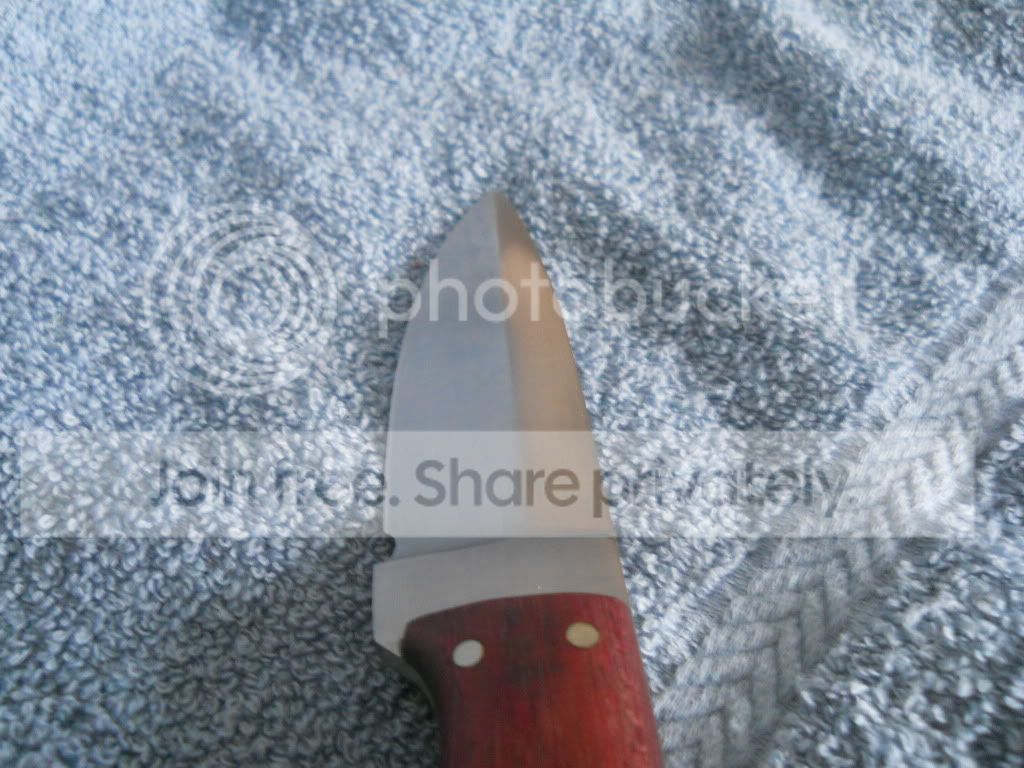

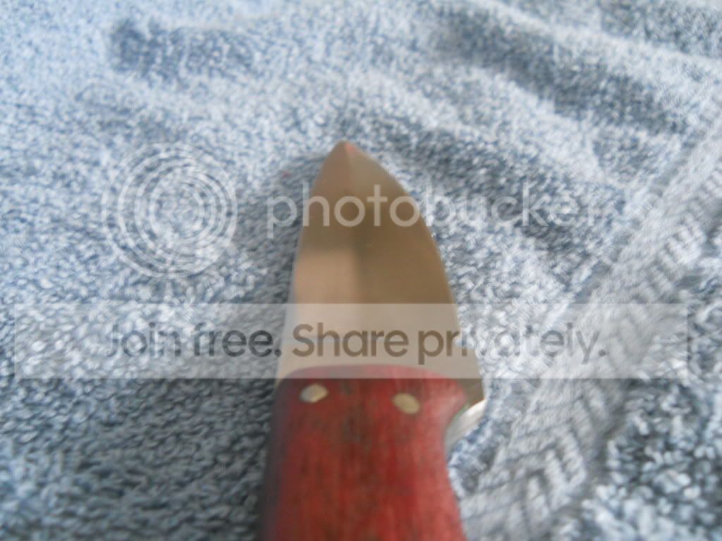

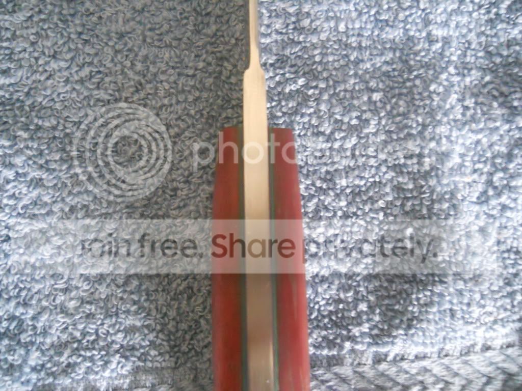

I really like the beveling on the blade. You get a much sharper center line than I have achieved yet. Looking down the spine it seems there is a different end point for the swedge (left to right). Am I misreading the images?

Greg, I believe I see what you are seeing, I think it's just a smudge or funny shadow.
