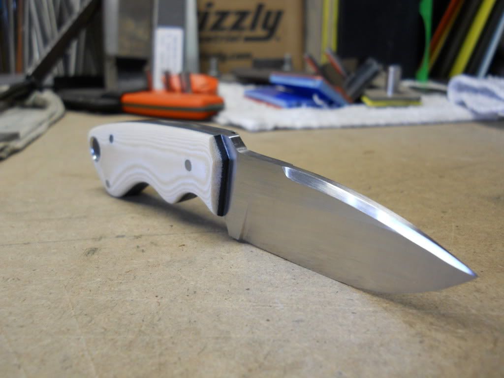

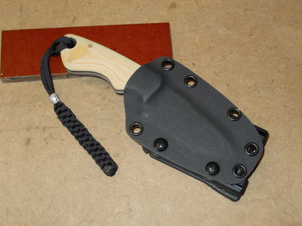

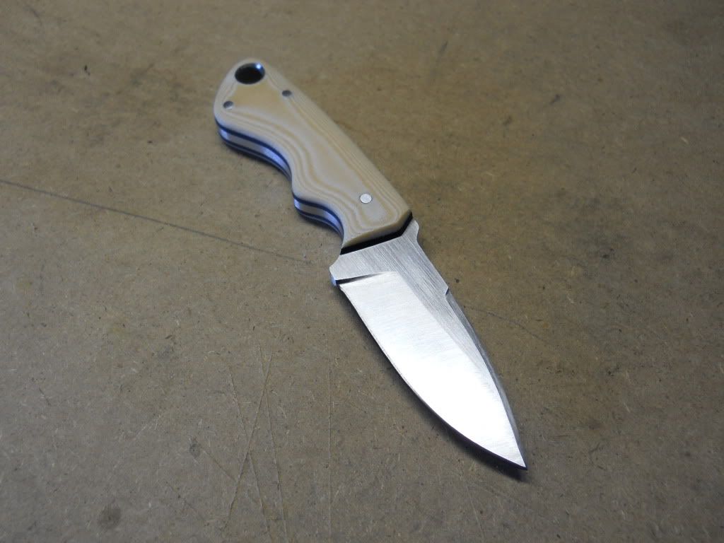

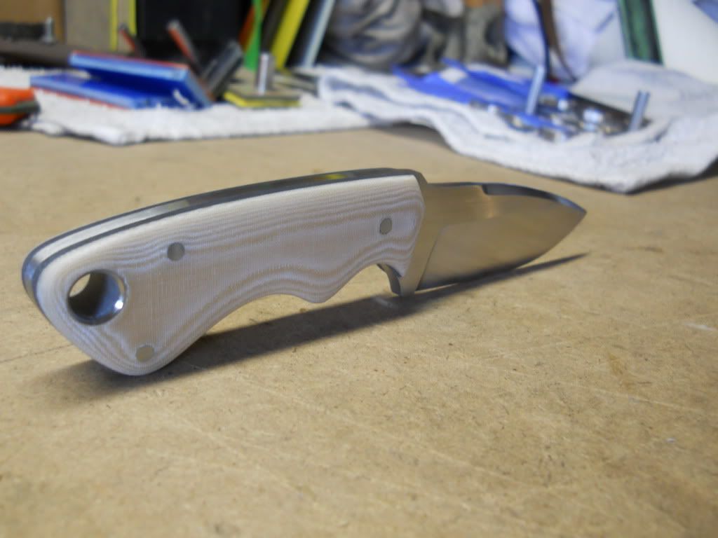

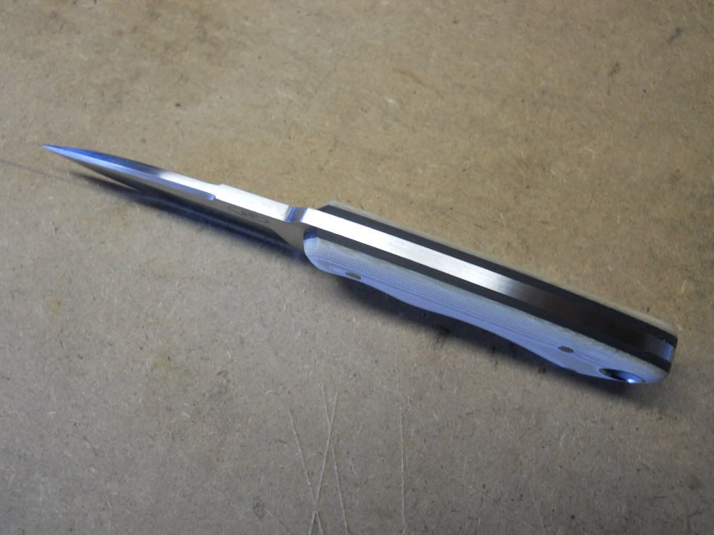

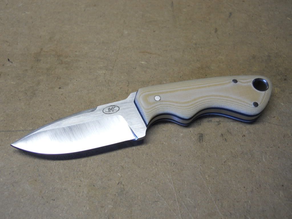

Here is one I just finished up today for a forum member. It's my Mini Drop Top model in Elmax powdered stainless. The blade stock is .156" thick. Overall length is just about 6", 3" handle and 3" blade with a 2.75" cutting edge. Flat ground with a 15 degree swedge. Handle is light tan/natural G-10 with thick black G-10 liners. Pins and tube are stainless.
