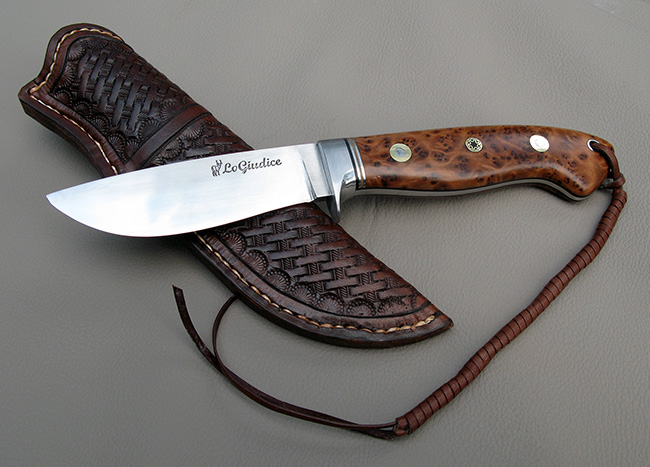

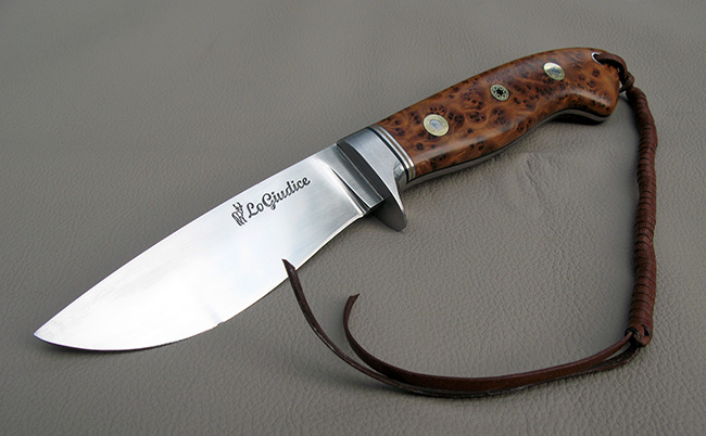

Thanks for looking! Comments and suggestions (good and bad) are welcomed.
I just completed and delivered the knife shown below to it's happy new owner.
Specifications:
Style: Drop Point Hunter with Re-curve blade
Overall Length: 8-5/8 inches
Blade: 3-7/8 inch, Hand ground CPM 154 stainless steel, flat grind, 800 grit hand rubbed finish, tapered tang
Hardness: 62 Rc.
Blade Thickness: 0.160" at ricasso
Handle Material: Thuya burlwood, Spacer: black G10
Guard: 416 Stainless Steel, Spacers: Black & Earth Brown G10 with 416 stainless steel
Fasteners: Brass and stainless steel Loveless screws, mosaic pin, & stainless steel lanyard tube
Lanyard: Brown kangaroo skin lace

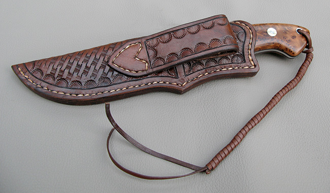

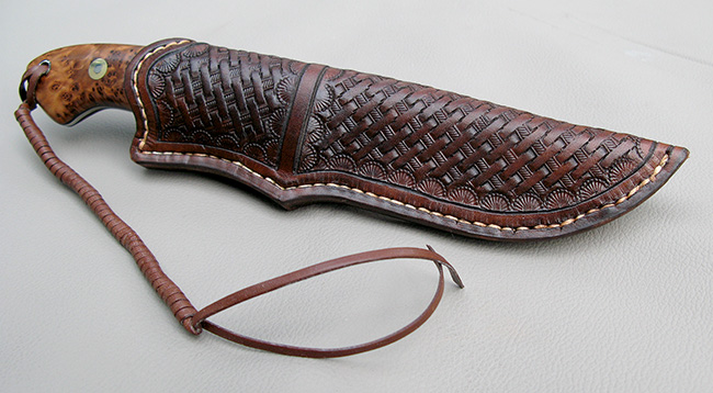

Sheath: Hand made by Mike LoGiudice, dark brown with black antique finish, sealed​
I love to make full tang knives with metal bolsters. I think you did a very good job on that one. The tooling on the sheath is very nice, too. Hope someone buys it for what it is worth!
Kevin,

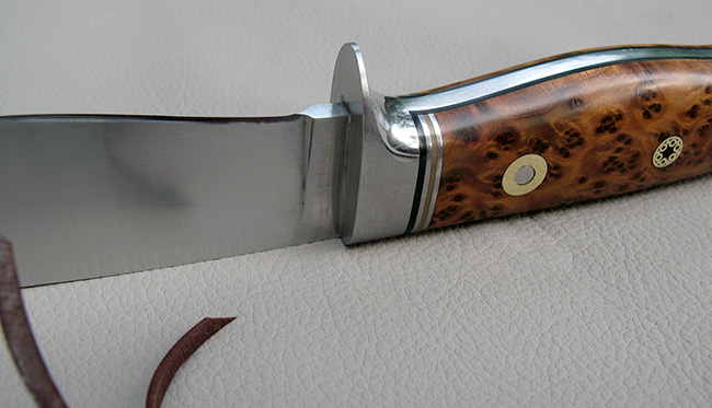

It's actually a slotted guard, but thanks for the nice comments.
I really like the handle and sheath. Not a big fan of the blade shape and your mark seems a little over powering.
Kevin,
Very nice. Excuse my ignorance, is the slotted guard open at one end so you can slip it over the tang? Do you then sodder it to the tang? Or slotted means just open hole to slide the tang through?
