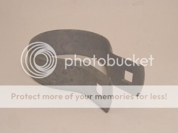

Knife #2 started off like this as well.

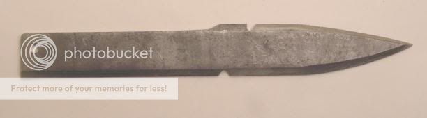

And ended up like this. Knife #2.

Heres the first knife I made for comparision.

you will live a lot longer if you quite messing with those galvanized parts.

I would like to use differant steels but the poll cuff was the best thing i could find.
