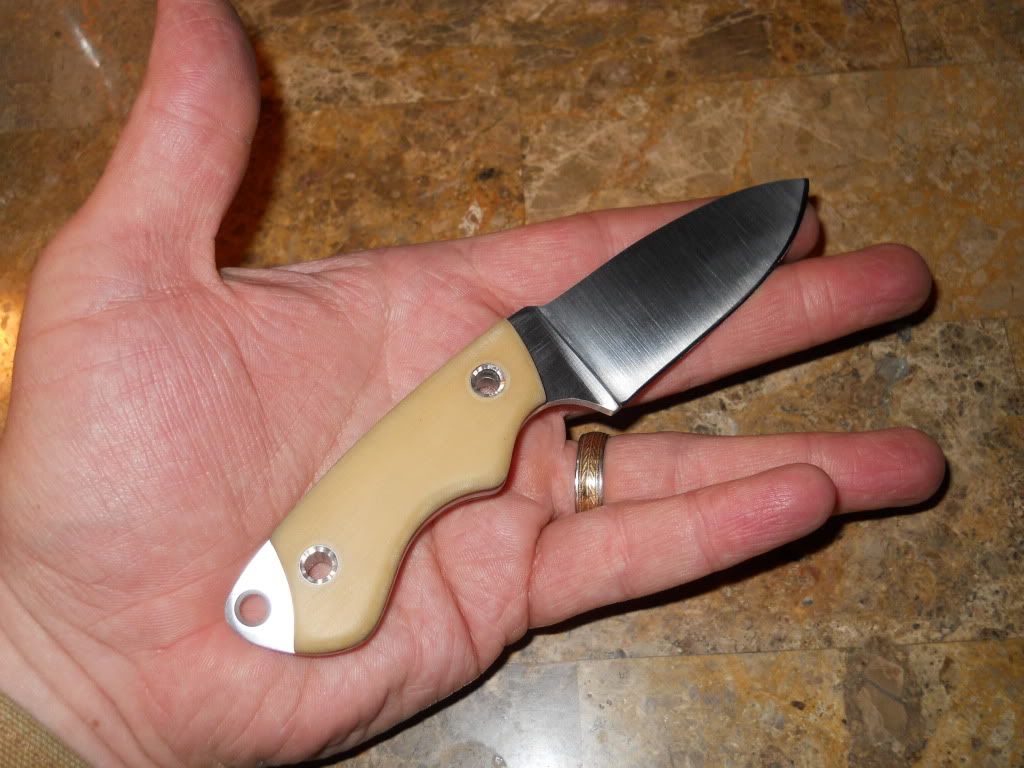

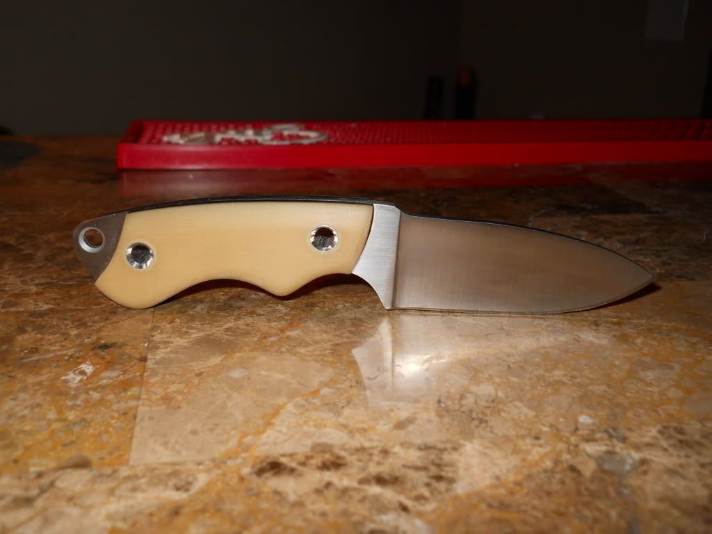

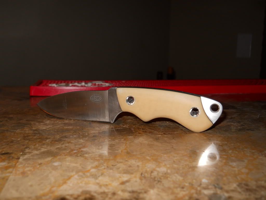

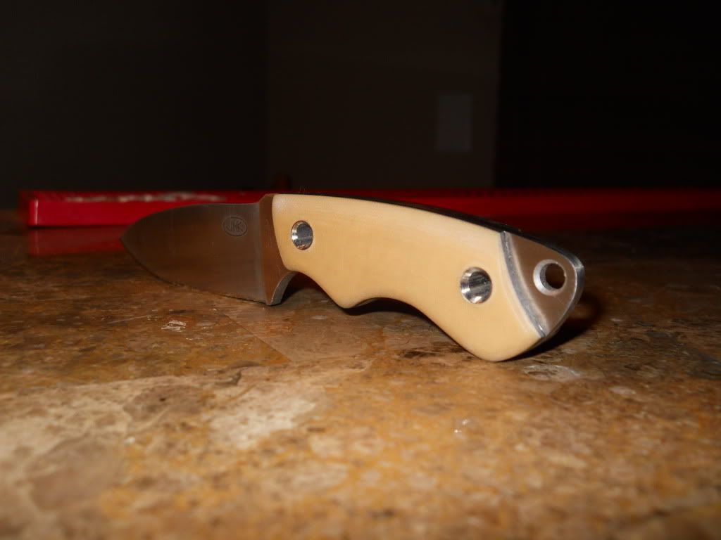

Just finished this one up tonight. Needs a couple touch ups here and there but done for the most part. .156" Elmax stainless, treated to 59RC by Peters. Measures right about 6" overall length, sand brown G-10 slabs with thick black liners and 1/4" stainless tubes. This is a little EDC I designed a little while back that for now I'm calling the Mini Drop Top. I think I'll make a few more of these.
Thanks for looking!
Hi jonnymac44 -
Very nice!
I think it would be a great cutter with the subtle arching curve. The handle looks very comforatable, and the whole knife just looks cool.
Thanks for the pics!

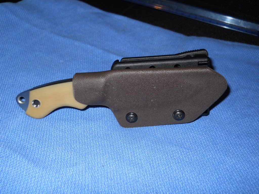

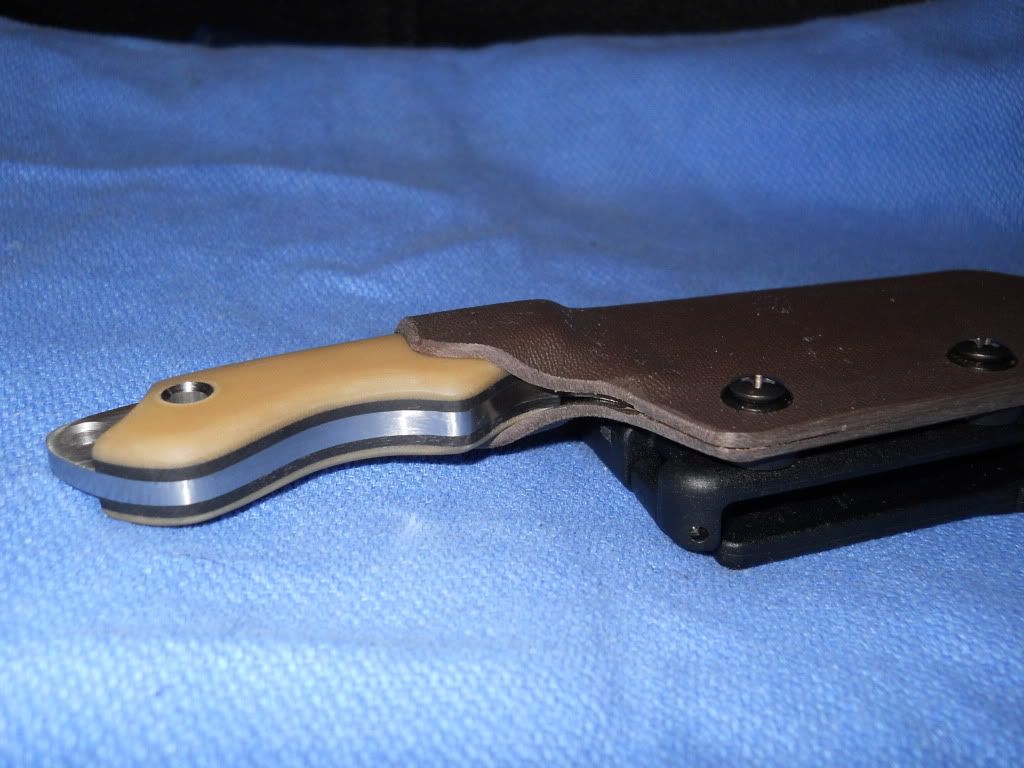

Just finished up the kydex this afternoon. Here are a couple of pics.
