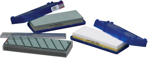

The Norton 4000/8000 would be a good waterstone for this knife.
Norton has a "starter kit" for about $120.
Includes: Instructional DVD
1 8x3 200/1000 grit combination waterstone
1 8x3 4000/8000 grit combination waterstone
1 coarse grit silicon carbide flattening stone

Could I use that to flatten a Japanese waterstone instead of buying a whole kit? I haven't used a waterstone before. Could I get away with just buying a Norton 4000/8000 stone? I don't think that starter kit is offered any longer - at least not at $120. The 4000/8000 stone alone is $80.
Would I be any happier by getting a Shapton ceramic stone(s?) That's more expensive because I'd need 2 stones at $56 and $80 respectively ($136 vs the $80 for the Norton). Unfortunately I don't see a combo stone from them - I'd love a 4000/8000 ceramic product if those clean up easily.
How long will that $80 4000/8000 Norton stone last? I've read that you consume the waterstones pretty quickly with use. I'm not a professional chef (obviously), so they'd only see light duty from a passionate home cook and knife nut.
The fine/xf diamond works great lapping the 4000/8000 Norton,
that's what I use. The 4000/8000 is my favorite finishing stone.
I use it for large and small knives. I keep my knives sharp so it
doesn't take long. Wear? Using it 3-4 times a week it still is in top
shape after a couple years. Just remember to lap it flat in the sink
periodically. After profiling the newer steels with diamond stones,
the 4000/8000 and black/translucent Ark. stones are all I use now..
