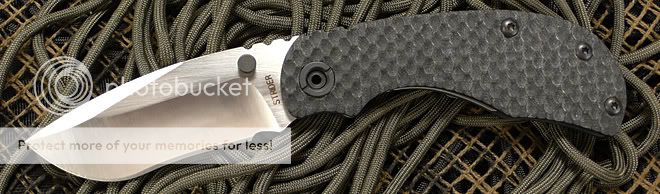

I just got a Strider RCC Sat (satin blade) from LA Police Gear and here's my initial impression. It came in a plastic bag, no box, no papers, etc. Seems strange to me but maybe that's how Strider saves money. I trust LA Police so I'm sure it was new. The knife was dirty, after holding it a bit, I had grey dust on my fingers. I cleaned it up and oepned it several times. It opens nicely but the liner lock is so tough to unlock that my thumb is throbbing now. I put some Wilson gun grease on it and worked it a few times. Still tough to unlock. I hope it gets better. The fit and finish seem good. It is a stout knife, .156" blade, gunner grip G10, titanium liners, etc. Overall I like it but disappointed in the liner lock, obviously not tested before leaving Strider, or if it was, poor quality control. Here's a couple of pics from the net of the RCC.

Those stiff liner locks are a good thing in my book and both my AR's have them. That stiffness assures me that the liner is less likely to slide off the blade tang on its own. But with use it should smooth up at the lockup point so there is no sticking of the lock. Oil will cause it to stick worse. Clean off all oil and use a pencil and mark the blade tang so that it is covered with the graphite. This should solve any sticking problems. As far as the stiff liners go, they will be stiff from now on as one of the properties of titanium is it's memory, being able to spring back 100,000's of times!

Cutter17, the graphite seems to have smoothed it out a lot, thanks for that tip. I think it will be fine now. The liner lock side is about 1/16 thick. The other side is 'real" thin. The G10 scales are 1/8" thick. Guys, Thanks for all the input.
Glad it worked for you. You may have to do it several times over the next few days until the graphite is sorta imbedded, and from one NC boy to another......Good luck!!
