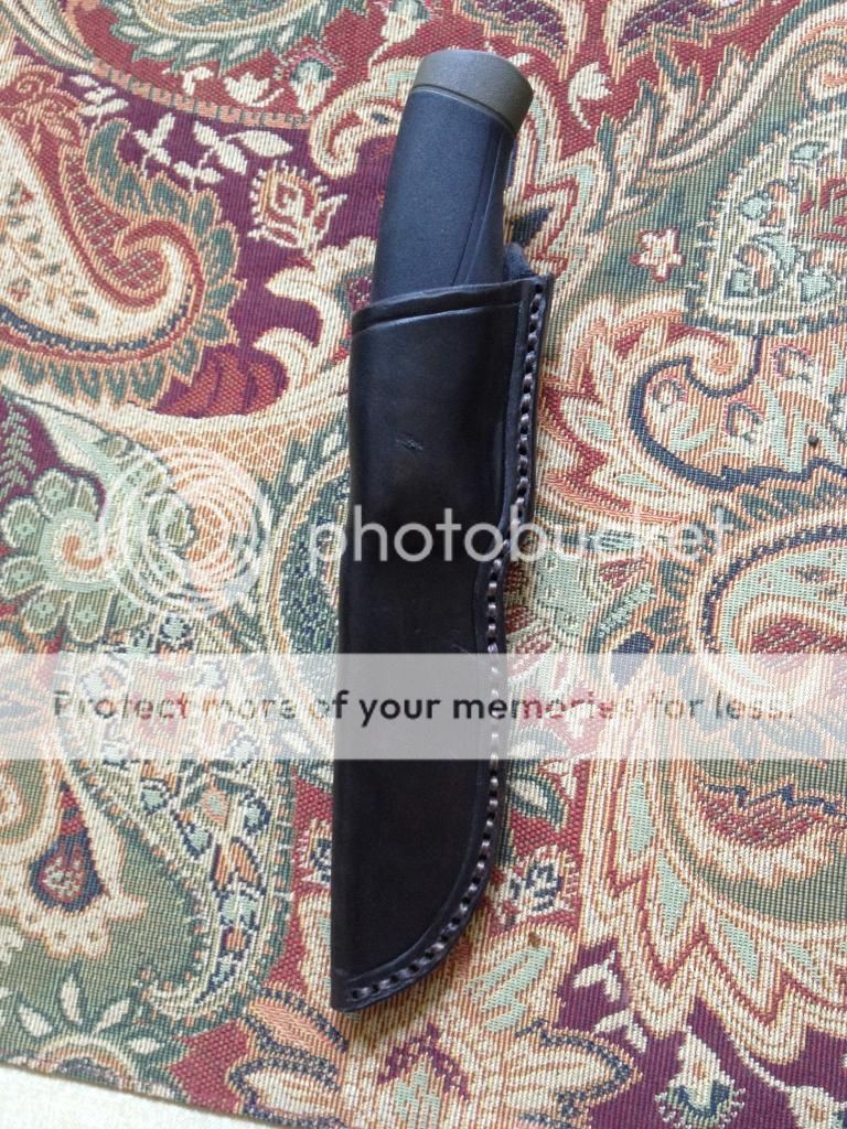

I've been hearing about Mora knives for years but never got around to buying one until recently. A classic 3 6 inch and heavy duty 4 inch, both carbon steel arrived today. Both seem exceptional value, but the scandi grind left me curious. How do you sharpen and maintain these knives? I have been using a worksharp KO for convex edges lately, but have always used stones. Do I tough up the edge with stones? sandpaper? These seem like great knives begging for use, but I don't want to lose that grind by creating an extra bevel / microbevel. I know the work sharp is not the answer, any advice appreciated. The classic 3 seems like it needs a guard and a leather sheath to be near perfect. Thanks, Julian
