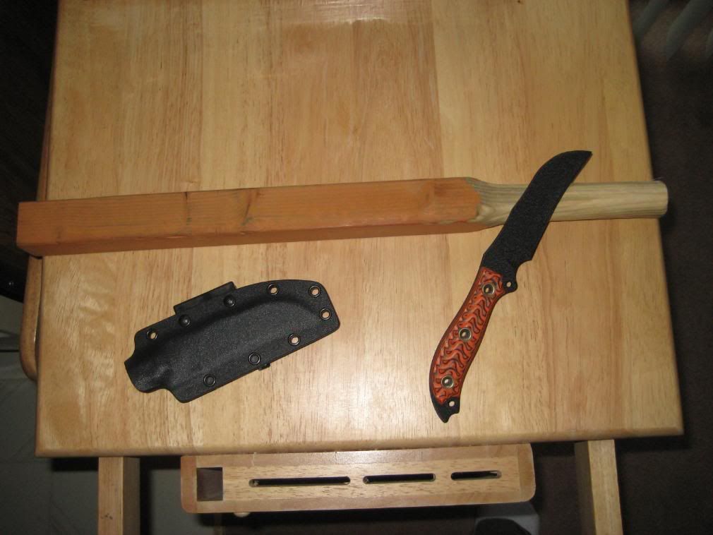

and picked up Dan and Spen's standard strop bat. It came in the mail about an hour ago.
First impression: This thing is solidly made from Red Oak and seems to be built to last a while. It has a lanyard attatched (in order to hang in the kitchen/shed/garage/workroom), but the material is thin, and I think JRE could improve it by making it out of paracord in the future.
Each of the four sides has a piece of leather attatched and three of those leather strips are loaded with compound, with the fourth being unloaded, finished leather bearing the JRE Industries logo.

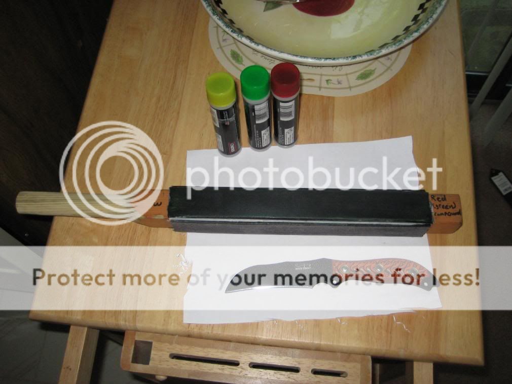

So I got this thing in my hand and deicded it was time to do some work. I first grabbed my kitchen-duty Cultie and tried working that a little bit. Now the Cultie has it's original edge geometry, a flat grind with a primary edge bevel. I stropped each side about 8-10 times beginning on the black compound, moving to green, following with pink, and then finishing up on the finished leather side. There was no detectable improvement on cutting performance, but I expected that knowing that the edge was not convexed. (That is a project for later)
Next I decided to move on to my SFNO, which IS convexed. Some of you may know that this baby got some bruises the other day (which I discovered upon closer examination are dents/rolls, not chips). I tried to steel the edge a bit so that the rolled edge was straightened, but it didn't work for me. Maybe someone can help me out with that. After attempting to steel the edge, both 2 days ago, and again this morning, the edge on the NO was no longer shaving sharp. I started by putting the strop bat black side up on my kitchen counter. I applied the logo side of the knife to the compound and began stropping. After a few strokes I kinda got the feel for the angle I should be keeping with the knife.
After about 8-10 slow, gentle passes (careful to let the weight of the knife do the work), I switched to the other side and did another 8-10 passes. I noticed that there was a little accumulation of compound on the both sides of the zero edge, so I wiped that down and moved on to the green compound.
I did the same for the green and pink compounds and then tried shaving a bit of paper. The knife would bite, but then it would tear a bit (I assume from the "wire edge") so I proceeded to move to the finished leather side and gave both sides of the knife about 7-9 passes. After this I put the knife to my arm and shaved yet another patch of hair from myself. Back to hair-popping! :thumbup: The only problem I noted was that the rolled edge seemed to leave a bit of a gouge on each of the four sides. I hope that doesn't affect the efficacy of the strop bat in the future.
