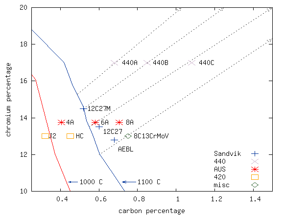

It's a good steel; similar to Sandvik's 12C27; but finding that steel with a good heat-treatment will be really really difficult.
That's what I always thought. AUS-6, similar to 440A; AUS-8, similar to 440B; AUS-10, similar to 440C.
cosine is correct.
Steel_______440A________440B________440C_________AUS-4______AUS-6_______AUS-8______AUS-10
Carbon____0.65-0.75____0.75-0.95____0.95 - 1.20____0.40-0.45____0.55-0.65____0.70-0.75____0.95-1.10
Chr______16.00-18.00___16.00-18.00__16.00-18.00___13.00-14.50__13.00-14.50__13.00-14.50__13.00-14.50
