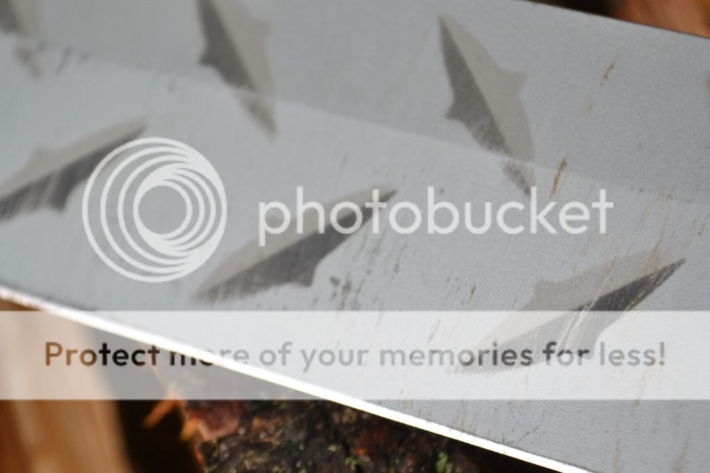

OK, this isn't a giant test of the durability of a -9, it just to test the coating, remember. After splitting a fire-sized pile I decided to check how we're doing.
While not extraordinary, we now have visible damage.
Yes. It did mark up the DuraCoat. But to be fair, given those same logs the original factory coating would be a mess, and the new factory coating would be covered in wood mash. Batoning is brutal stuff. I'll stick with Brutus for the splitting job, although I have to say a -9 is markedly more transportable!
So there you have it. Pretty much what I'd expected, and I hope I educated a couple of folks about the strengths and weaknesses of DuraCoating.
