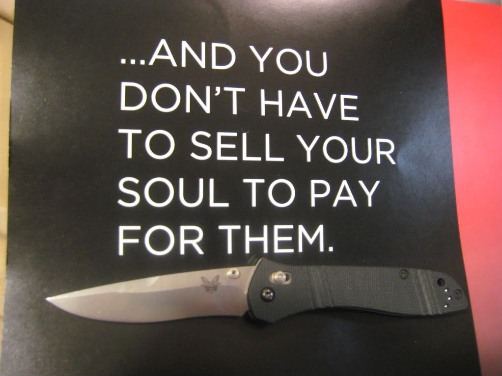

I made the order at knifeworks (heard this was a reputable dealer) . I'm kind of excited and a little concerned. Everyone here seems to really like this knife,but I've also heard that some people have a heckuva time sharpening the D2 blade. I've got a Lansky system with diamond stones here . Should I be more excited,or more worried?:)

I bought this one in D-2 and I wasn't happy with it's sharpness, so I touched it up on ceramic sticks and it got hair poppin sharp fast.
It flicks out very smooth and fast. Packs a lot of blade in a smallish handle and the lock is one of the best.
I have a lansky with diamonds. It will sharpen fast. no worries. I had a 710 D2 as well. I got it sharp with 20* then 25* back bevel. Would pop the hair off my arm (what was left)

got mine when i toured the factory last month! i love it. D2 isnt too bad. the week i got it, i put it on a cardboard wheel with 5 micron and it got very sharp. the recurve isnt too hard to sharpen.
