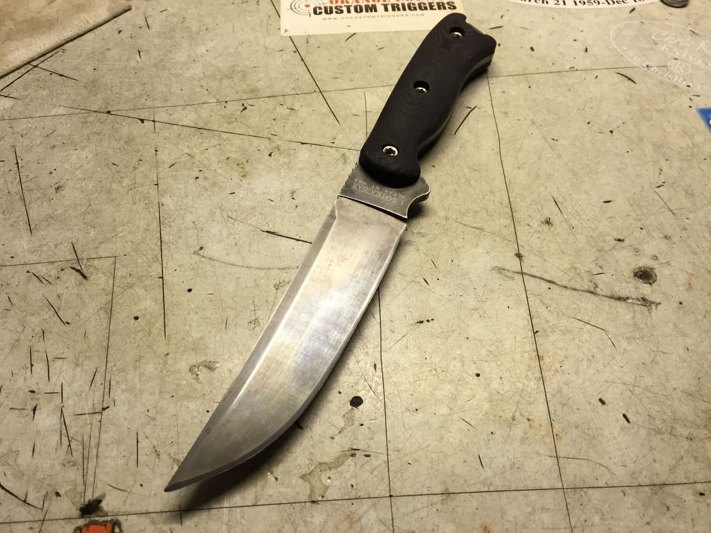

This is my stripped 15:
Yes strip it. You'll love it. Just do your basic care and it'll hold up fine. Use it often. Your issues will come into play if its just stored for long periods of time without a good oiling. Use it often, leave it easily available and you won't have any problems. Nice purchase! Check out the Becker forum, there's tons of posts on this Blade. I had 3, gave one to my brother whose not a knife nut and he's in love with it. Down to 2 so I'm feeling a bit naked haha.

Damn, that black micarta is sexy. Or is that the zytel?
Are you having Dex parkerize your 15? Please post pics of the results. I have a modded 9 that he did and I love the parking. If I could, I'd have them all done.
