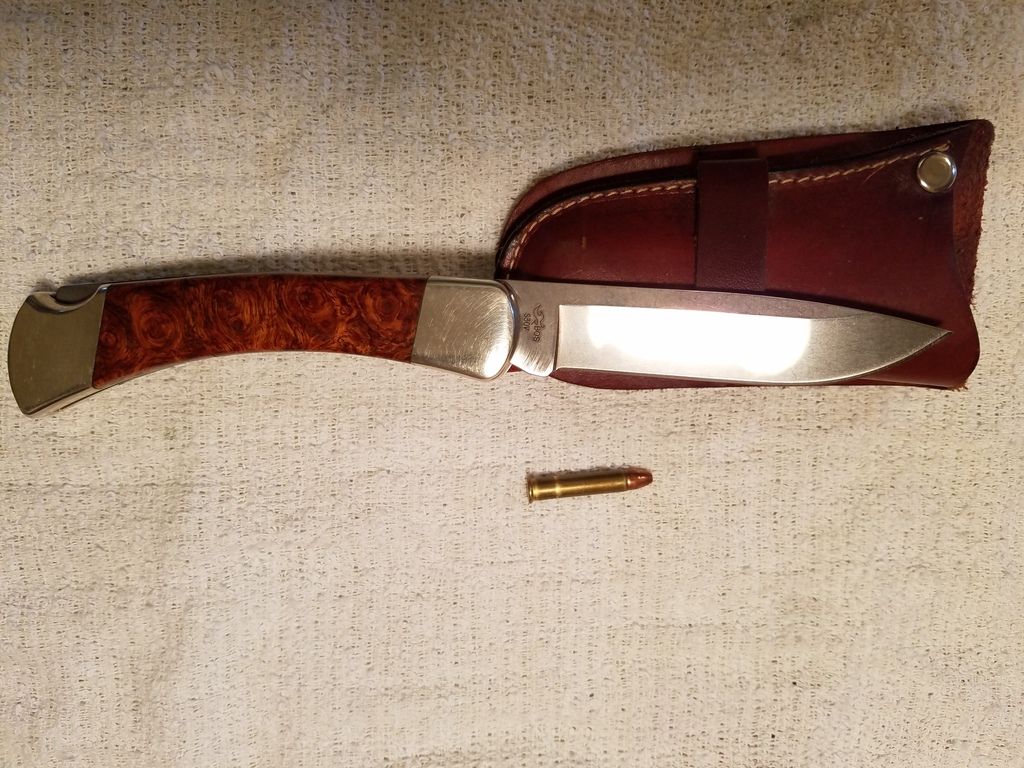

Ok, Dark here you go. A Buck Collectors Club 110 with nickle frame, S30V drop point blade with Buckeye burl. A 2004 offering. DM
The tip on a drop point blade might hold up better than on a clip blade for prying but I still wouldn't recommend it.
David, beautiful knife. The new buckeye burl wood in the custom shop has a gray color. I guess it can vary in color or they can make it vary in color.

Buck Shack, thanks. A collector member Flatlander did the scales. The frame and blade is from those first BCCI drop point blade knives. DM
