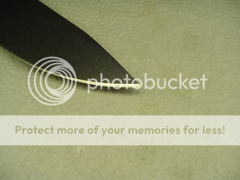

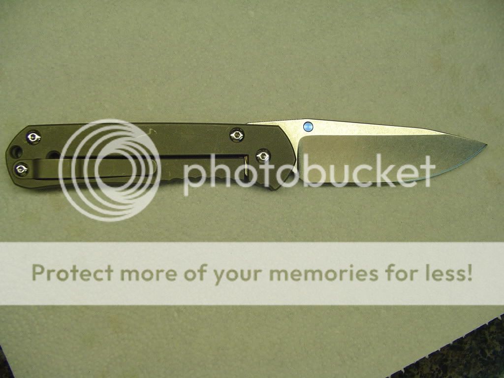

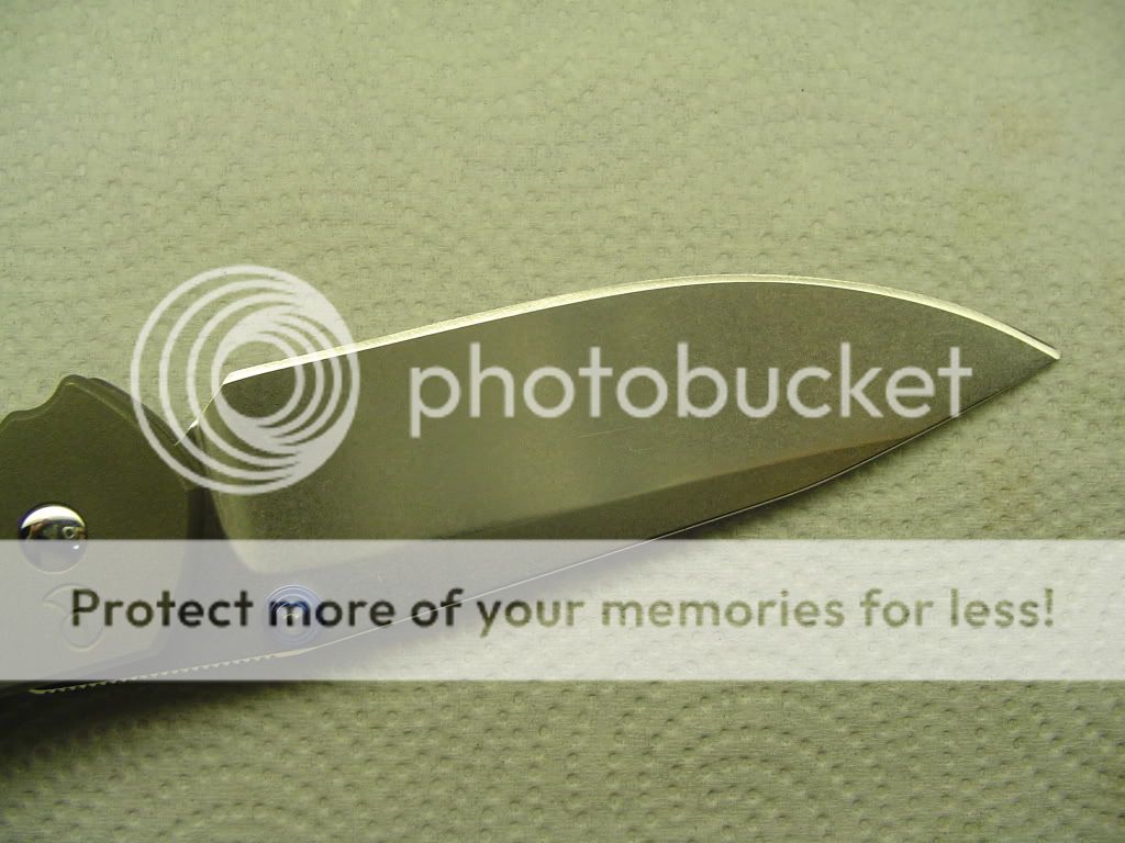

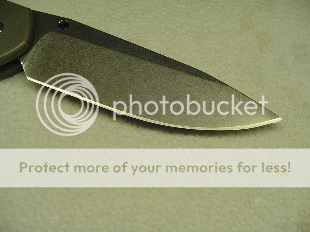

Just picked up this Large Regular...is this a CRK factory edge?
May 2, 2010
3,058
I'm still a newbie when it comes to all things CRK, so i really rely on everyone here in the forum for knowledge, info and the like:)
I picked this large up recently, and it is in very good shape. I'm a little skeptical of the edge though.
Does the edge look like it was done by CRK? or does it look like someone tried to sharpen it? I was told it has not been used, carried etc...
Doesn't look like it, or they did a neat job if they did.
The edge looks great, and ready to be used:thumbup:
I am not an expert, but I do own a bunch of CRKs, and I think that could well be a factory edge. The edges are finished by hand and there is some variability from knife to knife. :thumbup:
To my very untrained eye, it looks like it was sharpened with a Sharpmaker type of apparatus that utilizes a "slicing" motion. CRK usually leave a more convexed, even edge especially on the upsweep toward the point. I could very well be wrong tho.
with the few that i own(new/used), and the few that ive seen, i'd say it's not a factory edge

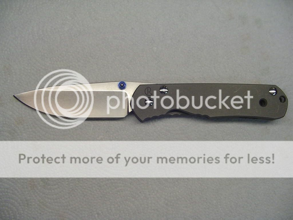

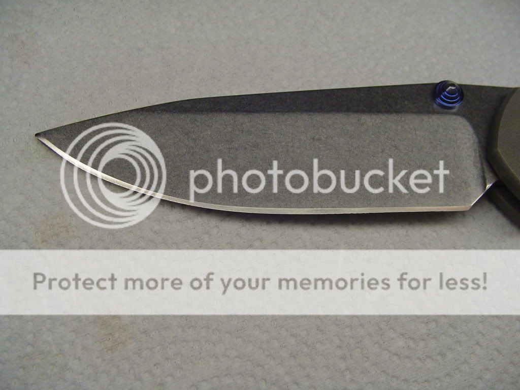

IMO that has been sharpened, the 5th and 6th pics show clear sharpening strokes. There are also places that look like the bevel wasn't quite met. I can see a few digs in there you will need to sharpen out too. :p
Thanks everyone....i'm thinking it's been sharpened too. I got it off a popular auction site. I've been wanting a decent shape large for a while now.

I think the seller of that knife was having a nice wee play on words to him self with that description. The knife may well have never cut anything or have been used by him but the person he bought it off sure has. It has clearly been sharpened, there are dings in the edge and the point is missing as well, the scratches on the handle are a bit of a give away too. :p

Yes, it Definitely has been sharpened. Looks like with a sharpmaker or like device as DallasSTB stated. You can see the un-even un-uniform bevel through the edge and the point is slightly rounded. All signs of someone not familiar with the proper use of the sharpmaker. Still a nice knife though and would make a great user for edc, its just does NOT have a "factory edge" as stated. Someone was not honest somewhere down the line before it got to you.
To me it looks like the tip was lost and never properly sharpened back, there are also what look like small chips in the edge along from the choil. A mashed edge seems to go hand in hand with a lost tip from what I have seen of the knives I have been handed to fix. :p
