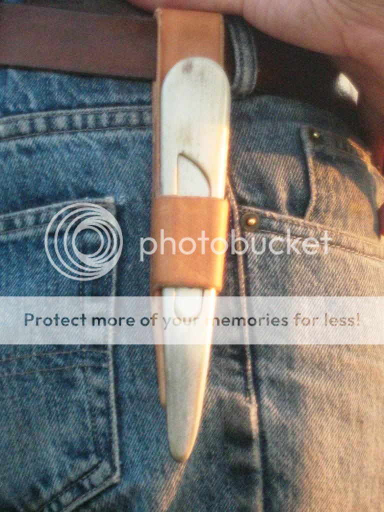

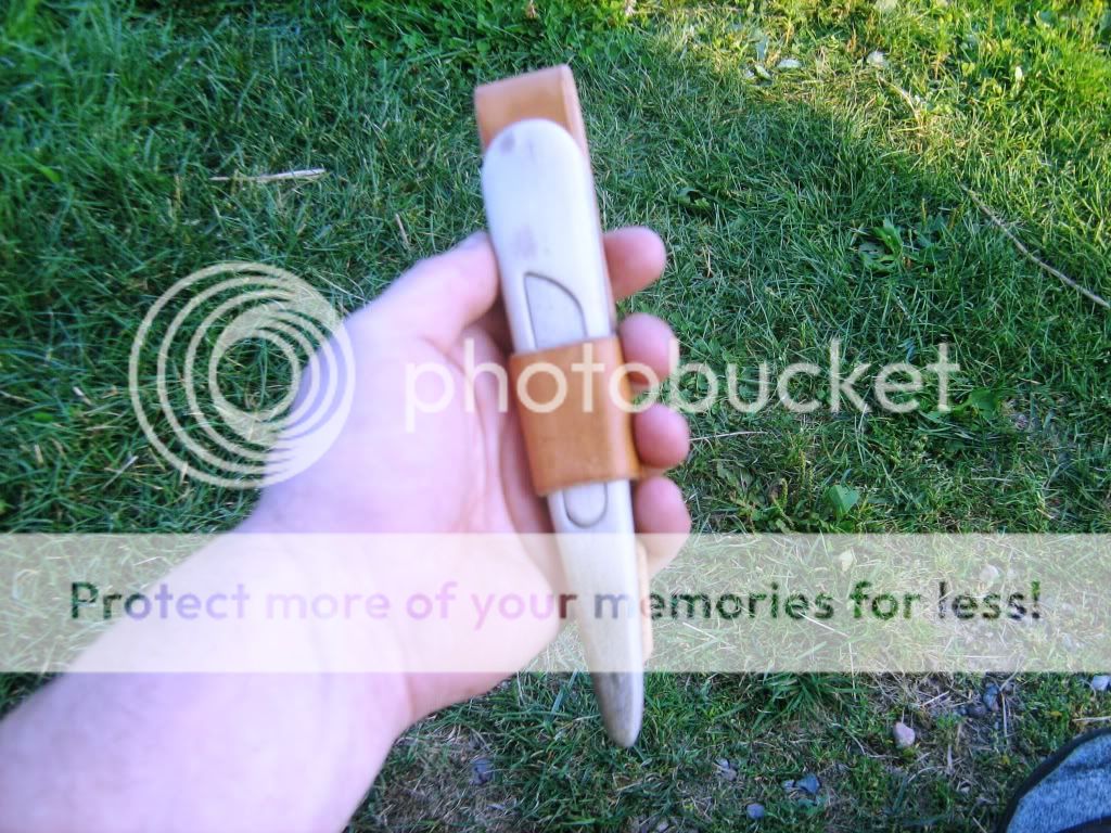

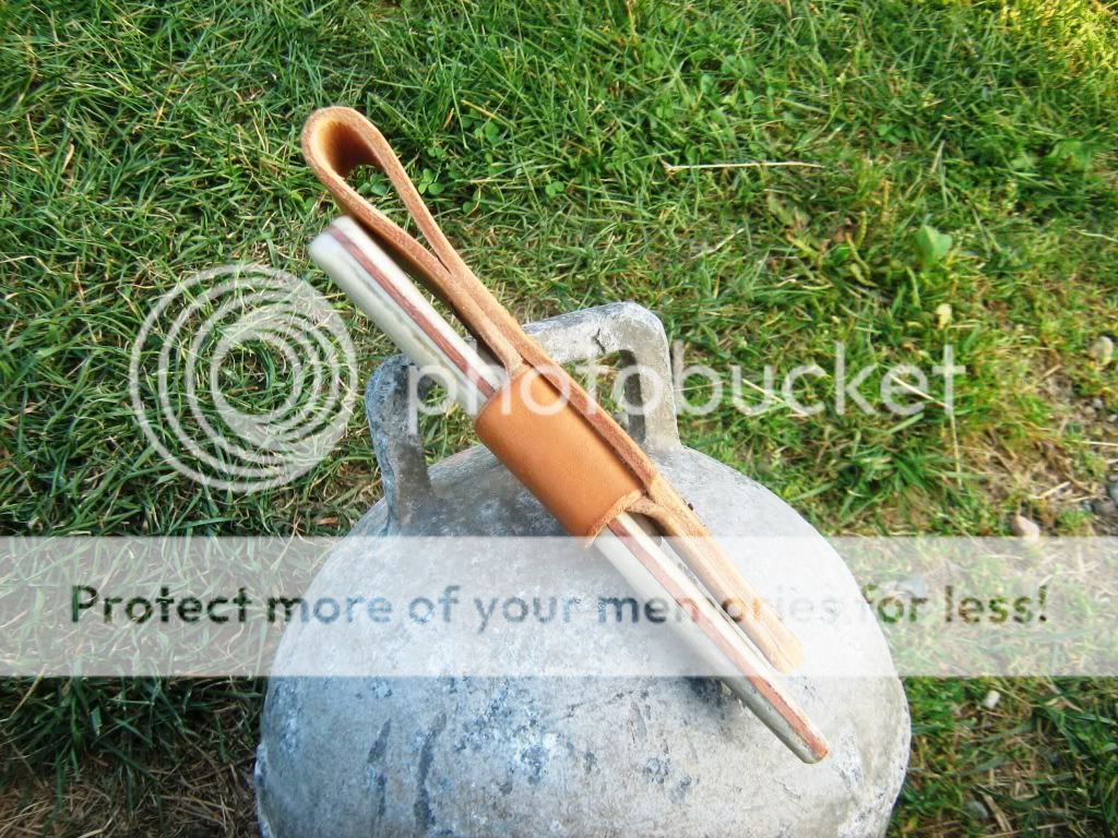

Had to get this one out of my head......
Xiphias Kiridashi
Blade: 3" x 1/2" O1 steel, chisel ground
Handle: Swordfish sword with Bloodwood liners and st. steel pins
Scabbard: Swordfish sword with Bloodwood "welt", inlaid with a rare earth magnet. Wet-formed 7oz. veg tan leather harness.
I'm not all too happy with the skanky belly leather I had to use for this. As soon as I get some better hide there will be a re-do of the harness. The magnet holds the knife in place VERY nicely, but just a light push on the back(front) side with a finger and the blade pops right out.
Anyway, I just wanted to play a bit and this is the result.
I hope you like it. Thanks for lookin'.
Man you are innovative. Does the scabbard double as something? It looks like a net tying shuttle.
Stuart - Thanks!
I see a marlin spike. :)
The scabbard serves no other purpose than to house the knife. The next version however..... ;)
Up to the 3rd picture, I was thinking what the heck kind of kiridashi is this ? 4th one explains everything. Very cool ! :cool:
I would think the scabbard would make a fine leather working/stretching/forming tool......you know, for those time when you need to throw together a sheath out in the field! :rolleyes:
