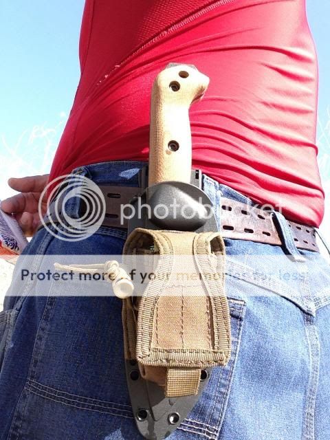

After installing a tek-Lok and a pouch onto mine, I'm actually quite a fan of the stock sheath now!
To loosen up the blade retention, carefully pull the knife from the sheath just enough so that the halves are at their farthest point.
Then hit it with a hot blow dryer. I let it warm up for about 5 minutes then let it cool. I was then able to draw the knife safely with one hand while leaving blade retention very secure. After performing these mods, I couldn't buy a better sheath for my BK2.
For giggles, my BK2 rig.
I left my knife pulled halfway out over night. I have never had the ramp pinch my thumb, especially now that the sheath loosened.
