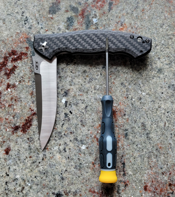

Hi, I just received my 0542CF. This is my first ZT. The blade is perfectly centered and locks up well. I did look at the detent lock and it appears to be 20%, at most. Is this normal and does it break in further with use? I also notice a touch of vertical play when closing the knife. If I open it 90 degrees and shake it, I can hear and feel movement. Is this normal for this knife. Dies tge pivot need to be tightened slightly? I cant do anything until Thursday, when my torque set is arriving. I never experienced this before.
It is a nice looking knife, very fast action and super light for its size.
Thanks
Wow, I just noticed that I can move both pivot points with my fingers, clockwise and counter! WTH, they are very loose.
Yeesh, I would not like that straight from the factory! I hope this is just a lemon. Sorry about that. Hopefully you can fix the pivot without further issue. Sometimes it justs needs a little tweak - hopefully this is one of those times.
Thanks, yeah, I had a similar issue with the Spyderco Military I sent back. That had a loose pivot also, was off center and had very tight action. It was my first liner lock though. Not a fan. It did have a much better and sharper blade in S110V. This ZT definitely looks sharper, great action and fits my hand better. Sucks that I can't do anything until my Amazon Wiha wrench set comes in.

Well, the loose action was definitely the pivot screws. I taped up my thumb with electrical tape and dug into those mag wheel pivots. I tightened them up slightly more and no more looseness/rattle in between closings! I will have to adjust correctly when I get my wrenches and blue loctite looks like a must. As for the lock up, I've read that with time it will improve. Hmmm. Thanks
As far as lock up goes, open the blade and lightly tap the spine on a hard surface with your fingers out of the way. If the blade stays locked in the open position, I’d say your good to go. I had a WE frame lock with early lock up and it was rock solid.
