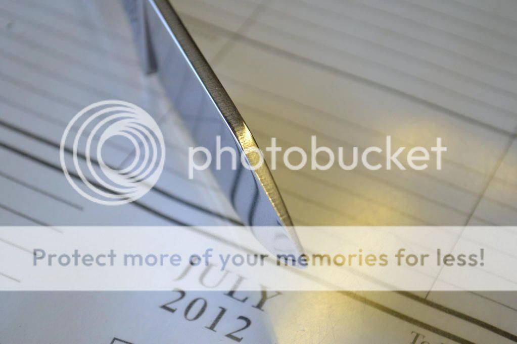

I had a Forum member contact me about doing a polished BK14, I had one in stock so I started this project that I thought I'd share. He's "considering" the purchase as I write this.
I made up a set of shortened scales, since what's the point of polishing the handle if you're just going to cover it up??? :D
Though I seem to be doing a lot of polishing lately, frankly, I hate it. I like machines to do the work, not my elbow.
That is all...

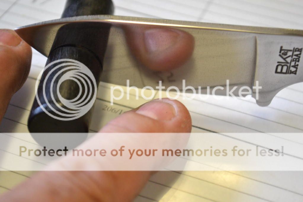

Yeah, they are the stock scales. I like to open up the lanyard hole on the factory scales for the -14, and when I was drilling out this set one of them got caught on the drill and cracked. Make lemonade out of lemons, I always say, and added, "Oh, I meant to do that!" :D

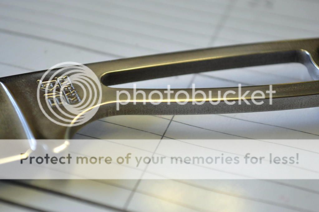

looks pretty nice. what do you use to polish it?
Media blasted the factory finish off, then did lots of wet sanding, finishing with a buffing wheel. Tried using my reloading brass vibratory tumbler to make it shinier, but it didn't work. It actually dulled the finish slightly and I had to use the buffing wheel again.
