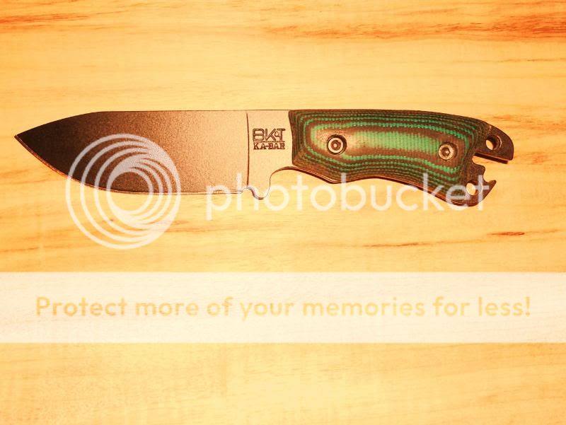

Well I finally got my milling jigs set up to make a few BK11 scales and the first test set was made from some Spruce Green/ Black canvas Micarta.
I used the factory style 6x32 socket cap screw/hex nut hardware on these and they overall, they came out nice I think.
About the only thing I am going to do different on subsequent sets is re-position the front screw upward a bit to center it better on the handle. Other than that , they feel and look nice.
I really dig the color combination for a woods knife. It would look way cool on a new BK-16.:cool:

Thank you for the compliment. It is much appreciated.
I followed the same basic factory pattern for design. I feel it gets the most from the BK-11.
This exact color of micarta is not made anymore to my knowledge and I only have enough to about a half dozen sets so I am darn careful with it.
They are finished to a 320 grit polish and simply washed with a bit of liguid wrench to deepened the colors. They are not very glossy and still have a grippy texture, about matte oil finish wood.
