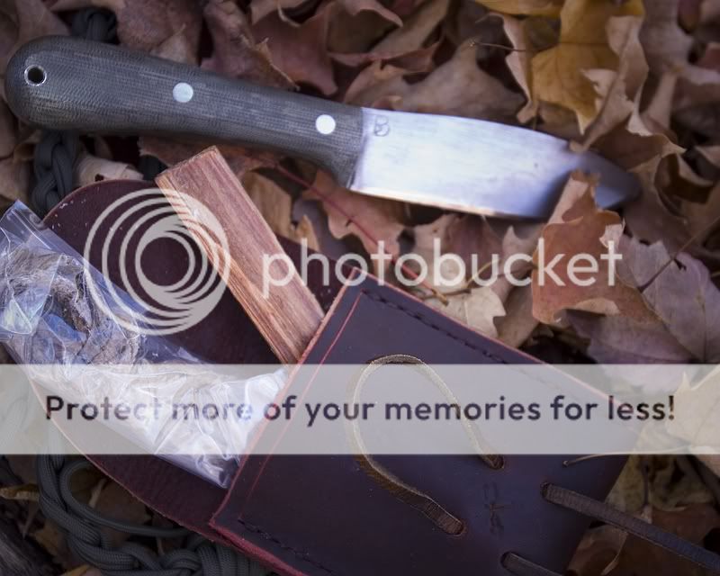

After seeing someone else here (WHO was it?) make the Jute + Wax firestarters, I made this fire kit last night, the firestarters are bundles of Jute soaked in hot wax then cooled. They are rock hard (and very waterproof, i soaked them in the sink for hours, under water, shook them off still lit after), but when you need to use one you "bend" them with your thumbs and they flex apart, with a nice fluffy powdery wax ready for flame. (see the one on the right). I thought the GL DREW knife with Jute neck cord fit nicely with the kit.
I use a bit of fatwood shavings on them
a spark from the fire steel and it starts to burn:
i snuffed out this one pretty quickit was really starting to flare up and take off....., i was indoors in the kitchen. I had one going outdoors it burned with a quite aggressive flame 4 - 6" tall). It was spittin rain but that did'nt faze it. I got about 15 minutes of very hot flame from it. Once its burning you can walk with it and it does'nt go out. One could fluff it up even more than i did for a bigger flame.

Ok that is frickin cool as hell. How did you do it? Double boiler some parrafin? And where did you get the pouch? If you made it, seriously bro, you should peddle some. I dig it.
yup, doubler boiler slab of wax, dip, soak, pull out with tongs and let cool until hard. The pouch was given to me by a former coworker, with some pipe tobacco. He had found it years prior and forgot about it.
So do you have a dedicated pot for melting wax? Or does it clean out pretty easily? I understand that only one has the wax in it with a double boiler setup, just curious if that is the end of that pot's life for anything other than wax melting.
yea, dedicated pot, its an old SS camping pot. I just put it in a pot of boiling water and let the melt wax. , Toss in the jute bundles, soak for a minute,etc

done BOTH! the wax ones burn for quite a bit, the PJ ones light quicker but consume faster. A 60/40 ratio of wax and PJ in the melting pot is a nice comprimise.
