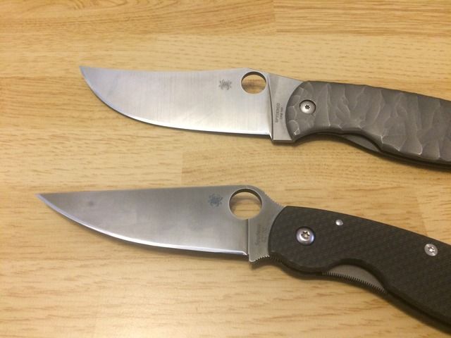

I did a forced patina on mine after I noticed a couple of spots start to appear. I tried using mustard with poor results. I ended up soaking the blade in a hot vinegar bath with good results. I removed the blade to do the patina job. I really like the way it turned out.

That turned out pretty good grimm
I think it looks great...very even / bluish / black...almost like you used gun bluing. Do you mind explaining the process that you used?
First step is to remove the blade. Be careful not to strip out the heads of the torx screws. Might need a little heat from a hair dryer to aid in removing the screws. After removing the blade, thoroughly clean off all oil residue, I used denatured alcohol. Next you will need a glass jar tall enough for the blade to stand up in. I used apple cider vinegar for the patina. Measure out enough vinegar to completely cover the blade. Then put that vinegar in a pan and heat on a stove till it is starting to boil. Then poor the vinegar into the glass jar with the knife.
I put the lid back on the jar and let the blade soak for a hour. I reheated the vinegar after an hour and repeated the soaking process. I did this to achieve a darker finish. After done soaking I cleaned the blade with dish soap and a green scotch pad. After cleaning wipe with a oily rag or silicone cloth then reassemble knife. The times for soaking are not that critical. If you soak longer it will probably just be a little darker.
