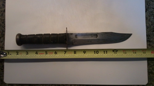

Hi, new guy here.
This is a long story for a forum thread so I will cut to the chase. I found a Ka-Bar in an old tool chest and was later told to keep it. I’m not much of a knife guy, I love the old Springfield 45 but for some reason I like this old Ka-Bar. It has stayed in my garage for a few weeks and I decided to fixed it up. It may not seem much to you guys but it means allot to me to fix this thing up, I can’t say why. It is just something I have to do for myself and for that old knife.
So my question is this, the blade is tarnished and the leather handle needs to be replaced. Any ideas as to how to clean and shine the blade up a bit? I don’t want a chrome blade or carbon fiber handle. I just want to clean her up, wrap the handle and know that “Baby” is there when I want her. And yea, I named her. I don’t know why...
-John

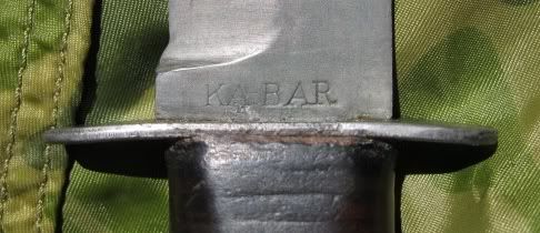

konaexpress,

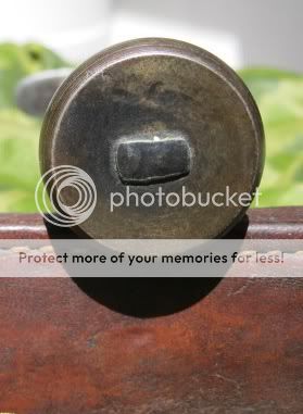

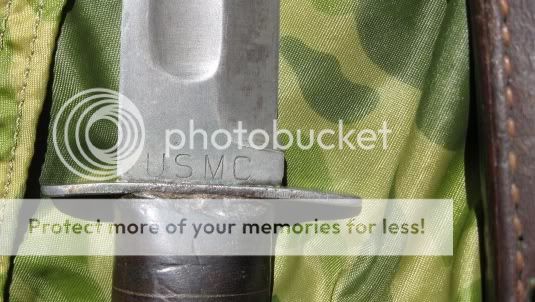

Can you post some more pictures? I'd like to see a close up of the stamp and the end of the buttcap.
Also some better quality pictures of the side view of the entire knife, both sides.
Are there any markings on the guard?
I believe you have an original WWII USMC F/U or USN MkII knife. Better pictures will give us more info.
In the mean time, do not do anything to the knife.

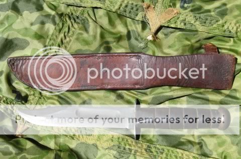

Hi and thanks for responding to my post.
I took these photos with a small Kodak Sport so the close-up is lousy. I will see if I can charge up another camera to get a better photo for you and no, I did not see any markings on the guard (the thing between the blade and handle?). The sheath does not look that old to me and it does not have markings either. it is brown leather with stitching and staples around the edges and a small hole at the tip, I assume to tie it to your leg?
Thanks again -John

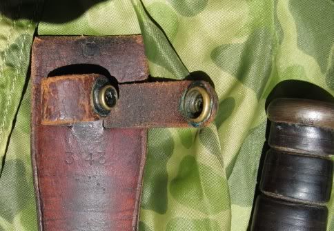

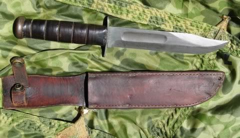

Looks very good to me. Toooj I'm sure will have more to say. From what little I can see of the sheath it also looks like it maybe period correct. If you see any words or numbers stamped on it could you post pics? If non, more detailed pics of it would still be helpful. I wouldn't do anything beyond cleaning it.

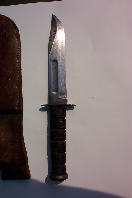

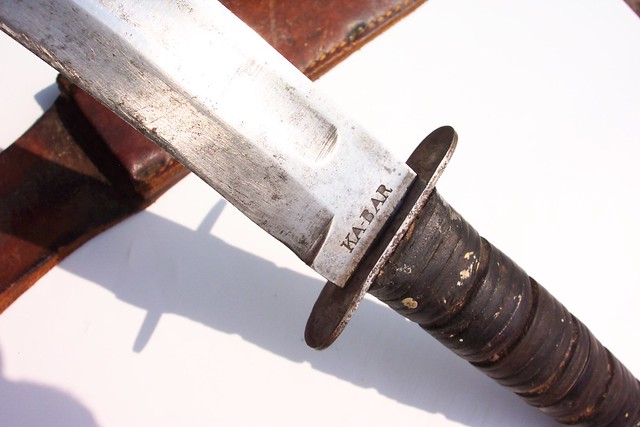

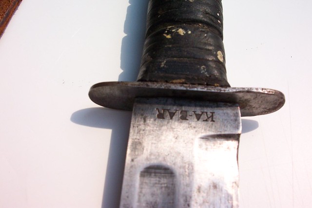

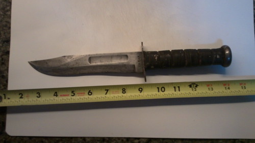

I’m sure your knife was made earlier during WW2 than mine pictured below.
This knife had the blade re-profiled at sometime. Can't say when it happened but otherwise a solid knife.
konaexpress,
There were basically 4 distinct generations of the USMC/ USN Fighting /Utility knife made by Union Cutlery during WWII.
Your knife is a Gen II (approx 1943). Narrow handle/ thick pommel/ round, threaded and peened tang attachment to pommel.
The plain leather sheath is proper and was made by Boyt.
It's your knife so you can do anything you want to it, but I'd just wipe it down with mineral oil and store it in a dry, stable environment.
You have a genuine piece of WWII history.
sac troop,
You are correct. Your version is a Gen III (approx 1944). The big difference is the rectangular, peened pommel attachment as opposed to that used on kona's knife.

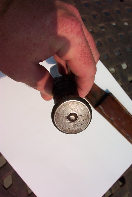

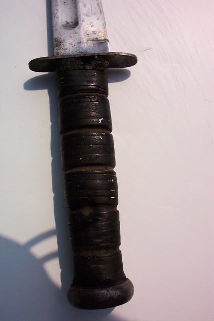

We have about the same story. I've had the bent and beat up knife for over 30 years. I sanded it to 2000 grit. Put a new handle on it--stacked leather. I will put some photos on one of my cheap-o web sites when it is finished in a day or so. I'll share how I did it with mostly hand tools.
