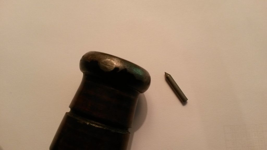

So. KA-BAR, thanks again to their sales department, have very kindly sent me a replacement pommel pin which will allow me to remove the current pommel, remove the leather handle and then conduct the refurb.
Question is, which side of rhe pin should be inserted into the pommel first?
It is indeed pointy side in, as found out after drilling it the old one out. The knife gods must have been smiling on me as even with a hand drill I managed to drill it out pretty much perfectly.
It wasn't too difficult to remove the handle once I'd got the pin out.
I then found a piece of leather, traced the outline of the front spacer and cut it out with my Spyderco UKPK.
Then I slid the handle back on, making sure it was all properly lined up.
Now, do I smash the pin in and smooth it out, or just epoxy it in and cut the remaining protruberance off?
I'd say epoxy plus a couple of good taps before the epoxy sets. I'm no expert but surely the historic way the pin was held in place was mechanical.
You did a good job on it. :thumbup: I've done this with one of mine as well. Use gorilla glue, it will expand when it dries. Use a liberal amount, then wipe excess off with a paper towel or rag after you push the pin in and give it a few taps with a hammer. I would recommend using a belt sander to get rid of the excess pin, then use 2000 grit wet/dry paper (automotive finishing paper) or a Metal Finishing Pad for a finish. You can find both of these at a large home improvement store. (Lowes, Menards, Car Stores ect.)

Thanks Dunkem and Zemapeli. It turns out I needed to get the pommel and handle a little more compressed to get the pin all the way in, so it is now flush with the pommel, without any abrasion necessary. There is a small gap all the way around the pin, so I think some two part epoxy will fill it up and retain it nicely.

Detail of the pin, after applying extra pressure to the pommel to compress the leather handle, I was able to get the pin all the way in. I will use a two part epoxy to fill in and seal the pin to the pommel.

Looking good. Sno Sealed the handle and clear epoxied the pin into the pommel.
