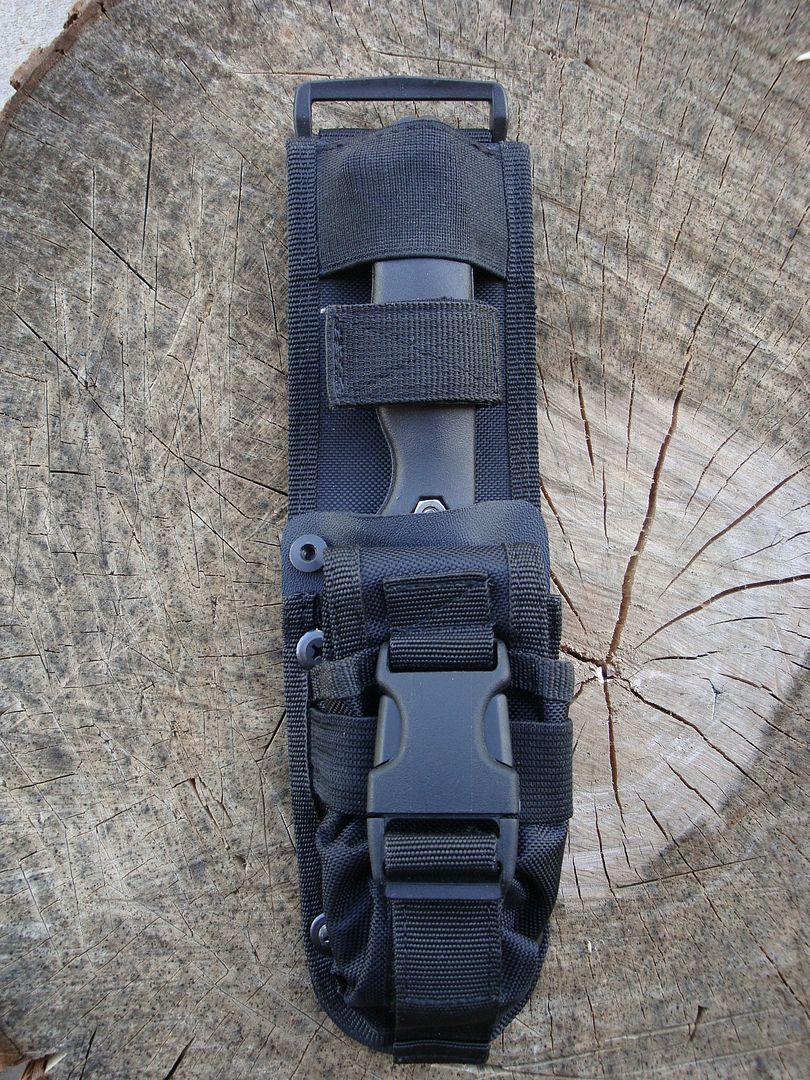

Hey ya'll,
I'm new to this forum and not sure if this is the right section to ask but I'm gonna anyway. I'm lookin to modify my Ka-Bar/Becker sheath and add an ESEE molle back to it. What is the Rivet/Eyelet/Grommet size used on the sheath and the molle back (they look to be the same) and where can I find them online? I wanna add additional holes but wanna make sure they look the same.
Thanks for the help!
You mean something like this? ;) This one is for a new Becker BK15. The ESEE backs and pouches are 1/4" grommets. There are several dealers for the ESEE molle backs online. Might check with theknifeconnection.com. Dale is a good dude. GPknives.com also has them. I usually get grommets from knifekits.com but there are several other suppliers as well. Which Becker are you modding a sheath for? Come on over the the Becker Knife and Tool Forum. Thats all we talk about there :D
Thanks UCPOPO,
I really like the way that sheath looks and secures the BK2! That's exactly the rig I'm lookin for!
