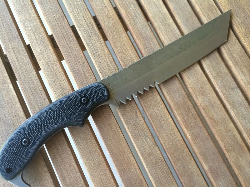

Got this on Saturday night, by yesterday afternoon I was basically done.
Etched, stripped and forced patina.
Before:
Etching
12VDC power adapter with jumpers clipped on
Distilled white vinegar and a crapton of table salt etching solution
Stripping
Citristrip for about 45 minutes to an hour
Stripped and patina'd thanks to the citristrip
Finished product:
Might put the dayglo green scales back on it to see what it looks like. Otherwise, might see if I can get some of the brown scales from a Johnson Adventure Potbelly/Baconmaker... Also, might look into a custom sheath.
Looks really good in my opinion.

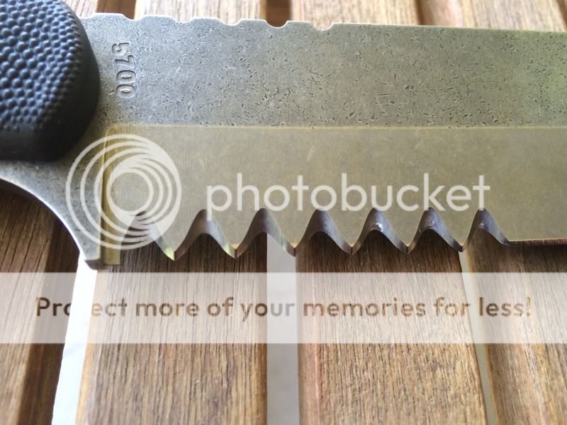

I was surprised that the serrations look like they put an additional edge on them to make them "pointy". I think that's new? Is KA-BAR doing that on all of their serrated blades now, or just this model? Not complaining, just curious.
That looks awesome! I wonder what my Taiwanese one would look like stripped?
Good work on that knife. I never liked the look of the zombie tanto until I saw this one. I like. :thumbup:
