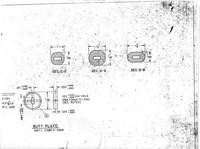

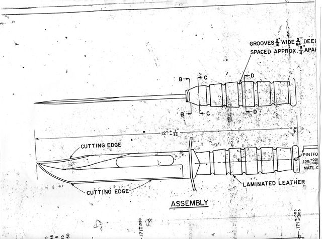

Here are some drawings showing some of the final dimensions of the leather washers and their location on the knife.
