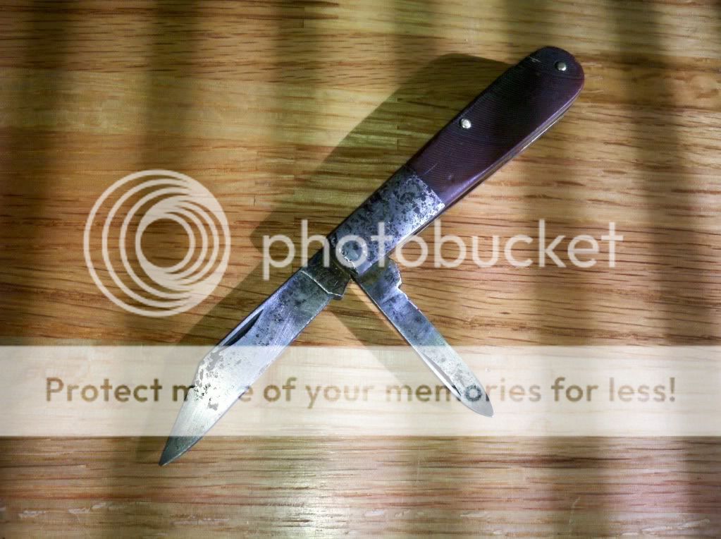

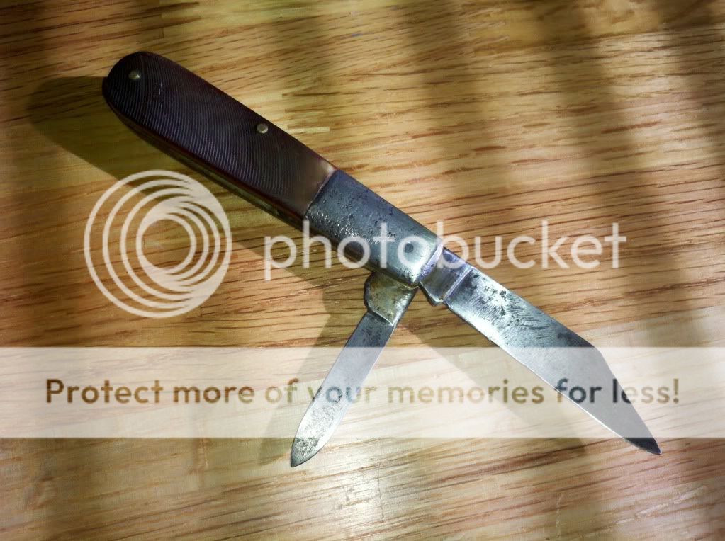

First time posting pics on here, so hopefully they work. The knife looks fifty times better than it did a while ago. Just imagine every spot of metal covered it rust and that's what it looked like. I'm attempting to put a point back on the tip as well, beings it was broken off a bit. It was definitely a user at one time and I think I'll make it one again. I got rid of some of the bladeplay using the tip from jamesbeat.
and it looks like its going good, not too familiar with kabar but it sure looks similar to a Camillus Barlow, they made knives for everybody...
Looks like its got alot of life left in it:thumbup:
Steel Bolsters, the handle is likely Delrin (sawcut texture)
Cant beat a Barlow one of the classic pocket knife patterns, even non knife nuts will remember the pattern name.
Keep us posted on your progress:)
gene
