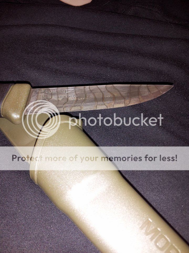

You should do what I did with my Mora, it is, in my opinion, the cleanest way to do a tiger-stripe pattern. It is durable and will protect your blade. Get Apple Cider Vinegar to near boiling, and completely submerse your blade in it (Make sure the coating on the blade is completely off). Leave it in the vinegar until the entire knife is pitch black, take it out and wipe it real good and run over cold water, make sure to dry it well. After that, spray it with alcohol and then wipe to make sure it's completely clean. Then, get some mustard, and squeeze stripes into it, I usually leave it for 15 to 20 minutes then remove the mustard by running it under water to get it off, do not try to wipe it off...You should get something like this.. You can do this without adding the mustard for a plain patina. You can also try other methods of adding a patina, but they usually come out really blotchy and unsightly.

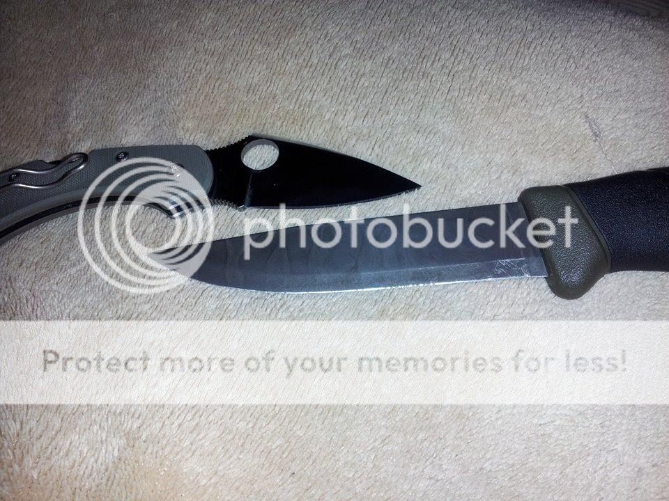

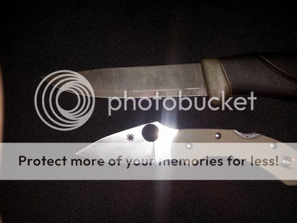

This is what the patina looks like after some use and the blades natural reaction to moisture in the air, still looks awesome, and once it wears off, you can just take the patina off with Brasso and re-apply
