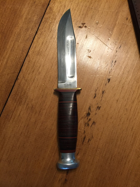

I'm looking for model/style and year of manufacture. Any interesting info about the knife and its history would be appreciated as well.

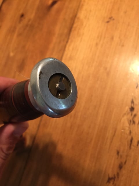

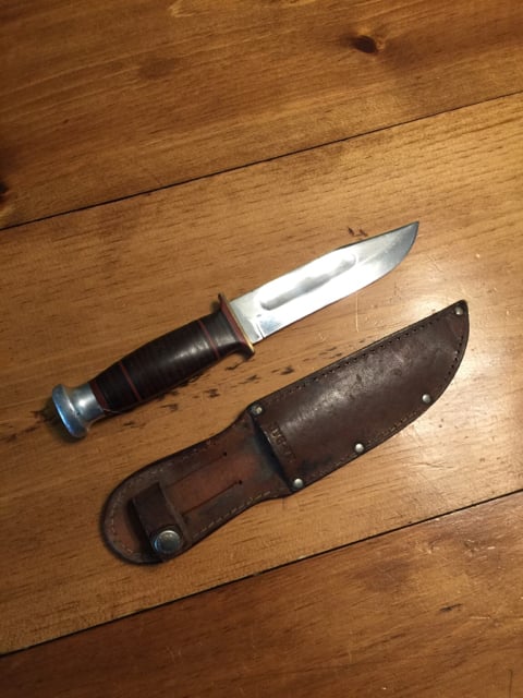

Your knife is a model 594. The KA-BAR over OLEAN, NY stamp was used during WW2 but since your knife has an aluminum pommel and aluminum was not allowed for civilian use during the war your knife was likely made between late 1945 and sometime in late 1947 or early 1948 since that was about when the mark was changed to KA-BAR over USA. It is a civilian hunting knife, not a military knife as they are often called on ebay. The model 594 is first seen in folder (catalog) #36 which was published circa 1936 so it is not an early model. The pre war ones will have the Union Cut Co stamp on the back ricasso. Your knife is in very nice condition and the sheath looks original although it does look like the pommel nut has been tightened over time. The folders show finger grooves in the leather handle but this may be because the folders are pre-WW2 and later ones had no grooves. I have no wartime or 1946 or 47 catalogs or folders to confirm this but it is logical. If anybody does have wartime or early post war folders, catalogs, or price lists please contact me as I would like copies or originals for my library.

I have seen a knife that is considered an example of a WW2 production of a knife that was likely part of the Navy Mark 1 procurement, which is very similar to this one in the OP. Blade type, (saber ground w/ fuller), length and markings are the same.
Differences are:
Blued finish
Steel half guard.
Black/red/black spacers, only at the very ends of the stacked leather.
Wood pommel w/steel butt cap.

Sac, Union Cut made plenty of hunting and pocket knives for the civilian market during WW2, so I do believe at least catalog supplements and price lists were published. Dealers would have to have at least price lists which are very rare from any company but somebody may have some somewhere. I have only acquired three price lists from Union Cut in 30 years of looking, they are RARE, but I am sure there are more out there. I do have the entire production of pre-war hunting knife folders, there weren't many and it took years of searching and trading to get them. The wood pommel/steel butt cap hunters are all WW2 production for the civilian market and there are also stag and celluloid handled versions known that were made for the wartime civilian market.
