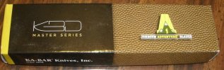

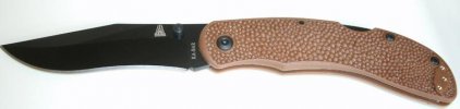

I picked up a Ka-bar JAB Baconmaker folder (#5598) to check out. It came in the mail today. I have to say that I am very impressed with the knife. (No surprise there, it's a Ka-bar!). The knife is made in Taiwan and marked so, along with the #5598 on the right hand side of the blade. The left hand side is marked KA-BAR and has the JAB logo by the thumb stud.
Specs:
Weight: 0.20 Overall length: 7 7/8"
Blade Length: 3 3/8" Blade Shape: Baconmaker
Blade Stamp: KA-BAR/JAB Steel: AUS8A SS
Serrated: No Lock: Lockback
Handle: GFN-PA66 Blade Thickness: 0.112

Here's an in hand shot. The grip feels fabulous to me. Texturing is great and it has a very slight palm swell. This would be a great folder for field dressing game or working in anything where your hand gets wet, slimy, or grimy, as the grip is very secure. I just can't see much slippage from it, regardless of grip position.
The blade coating is very smooth with no texture at all. As usual with Kabar, the knife came shaving sharp, almost hair popping sharp. The edge grind is just the slightest bit uneven, but I have never personally handled a recurve blade from a production company that was perfect. It doesn't bother me in the least.
