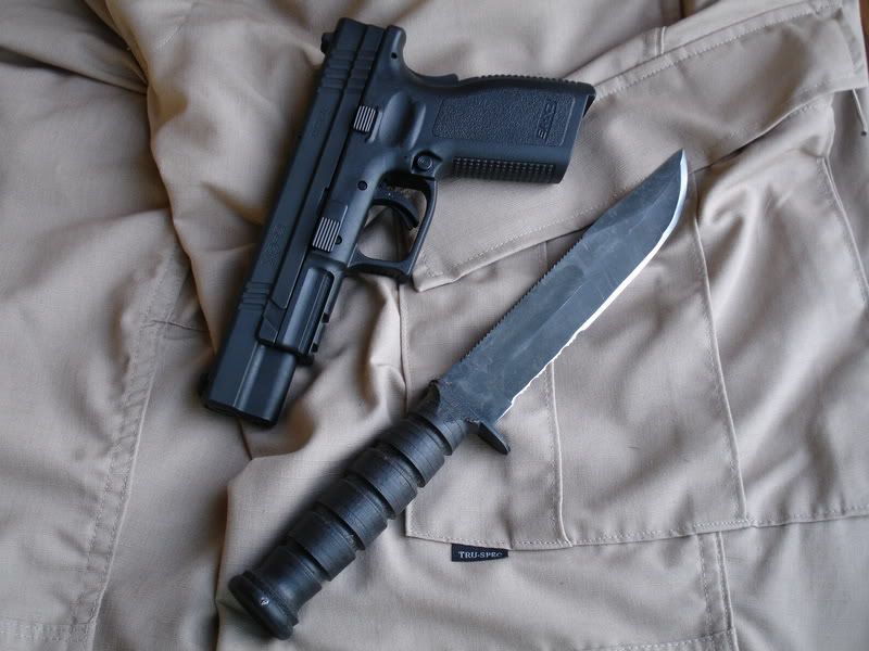

Yep, shaved the top guard off of my Camillus 5684MK shortly after I got it. Removing the top guard really makes a huge difference in how the knife feels and handles. I'm happy I made the modifications.
Sorry, this is the only picture I have of the knife:

nah good pic. Gives me a real idea what it'll look like. thanks.

I shaved off the top guard so I could use a larger variety of grips when using the knife. For example, when caving, I can 'choke up' on the blade a little bit, carefully and mindfully placing my index finger in front of the lower guard and resting my thumb on the spine of the blade. Also, the 5684MK has a Pilot's Survival Knive saw on the spine, and removing the top guard makes using that feature easier. Not that I use the saw on that knife much at all for anything...

Yep, the so-called "Kar-Bar".
Along with removing it:
- Sanded and shaped the handles into a more barrel-shaped design
- Drilled a lanyard/thong hole thru the butt cap
- Re-painted the handles
You have the exact Camillus I do (PS, sawback). But I took all the black stuff off the handle and blade. Now it looks more like an old hunting knife than a fighting knife. Camillus finished the steel under the black coat much better than Ontario.
