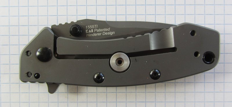

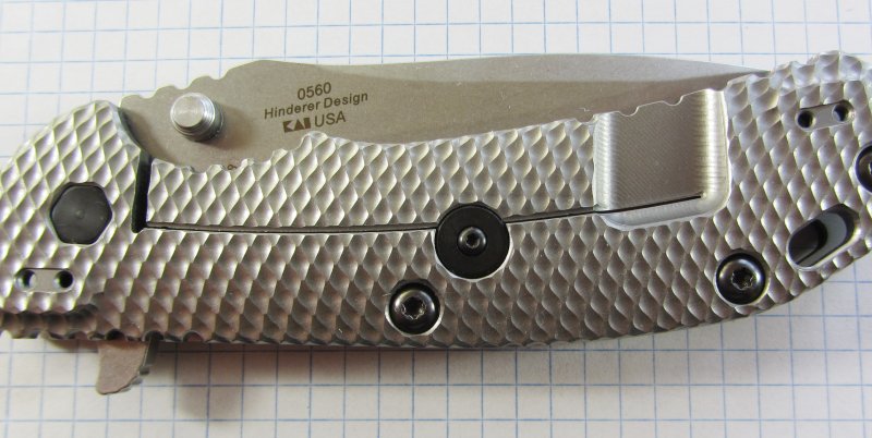

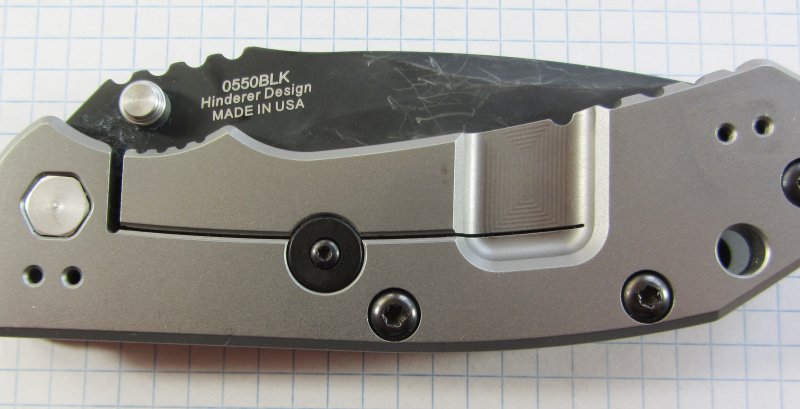

The LBS from a 0550/0560 will not fit in the Cryo. The hole on the LBS is too small for the screw. You could drill it out to make it fit though. On the flipside, the LBS from the Cryo will fit in the 0550/0560 (just using the original screw from the ZT). It is a snug fit though. On my 0550, I could feel the lip of the LBS cavity on the Ti slab hitting/clicking against the LBS when disengaging the lock. It did this a little on the 0560 as well, but not as much.

LBS from Cryo in a 0550 and 0560:
LBS from 0560 in a Cryo (sans screw):

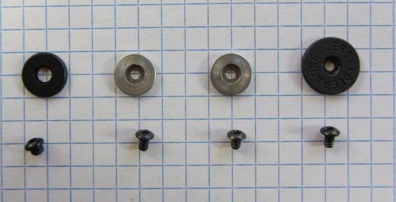

LBS from (left to right) Cryo, 0550, 0560, 0301:

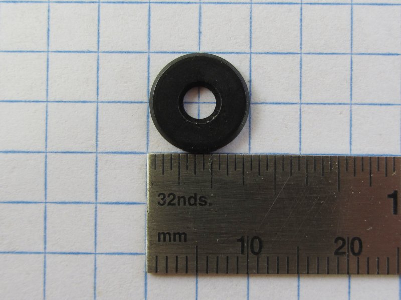

Close-up of Cryo LBS:

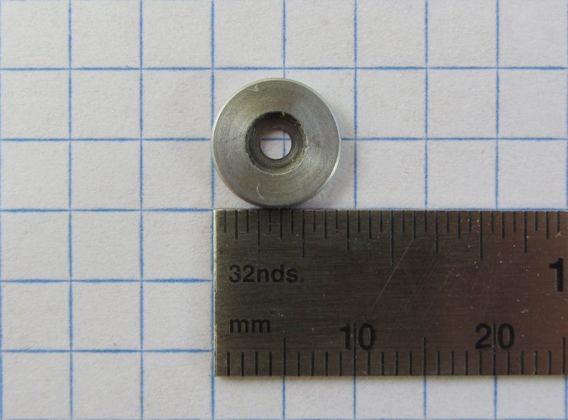

Close-up of 0560 LBS:
