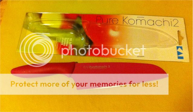

while shopping at a department store today i saw a KAI pure komachi 2 santoku knife (6.5"). i picked it up and looked at the price, a whole $4.99. i thought to myself "i have been teaching my 9 year old daughter how to cook lately, this thin and light 6.5" fuchsia santoku knife should be a good starting point into cutlery. and at $4.99, it cost less than the pound of coffee i was holding in my other hand." i decided i would test the knife out before letting her use it, so i made the salads for dinner tonight using the knife (to go along with pizza pie i picked up).
my initial impression of the knife was that it is thin, light and the edge came pretty sharp with no imperfections. the factory edge angle looks to be around 18-20 degree per side. i figured it would be a pretty good slicer.

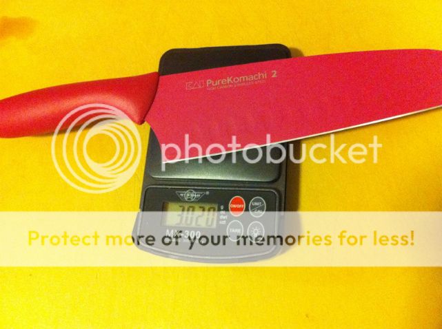

weight = 3.0oz

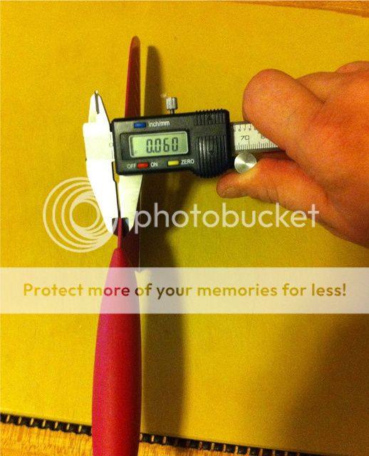

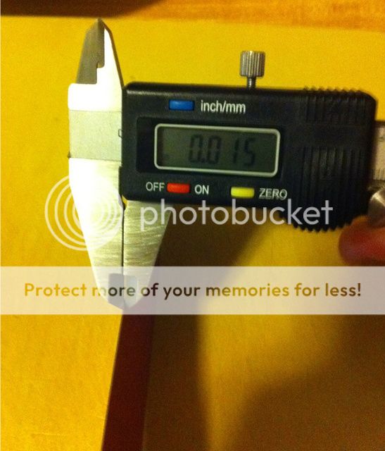

thickness = 0.060" at the spine and 0.014"-0.015" behind the edge.
