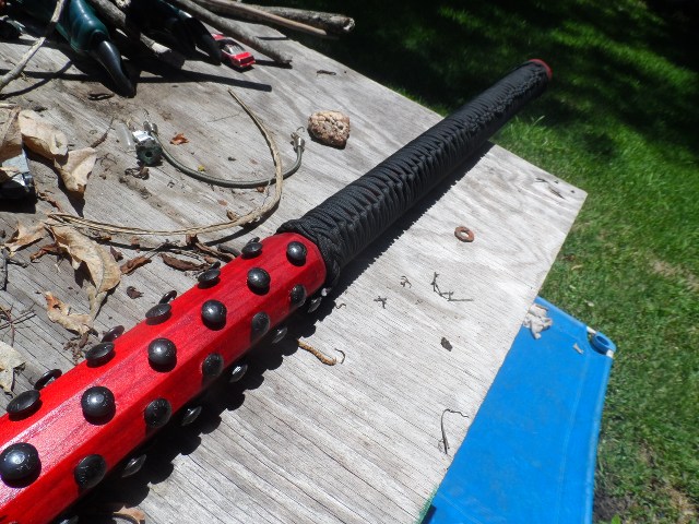

Wood is shaped and sanded waiting on weather to cooperate for stain and seal...bolts showed up today as did the paracord for the handle wrap....
with any luck I'll be able to post finished pictures over the weekend sometime....

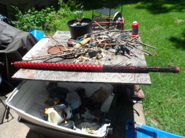

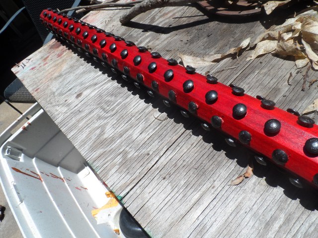

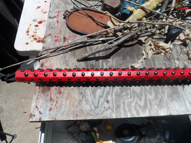

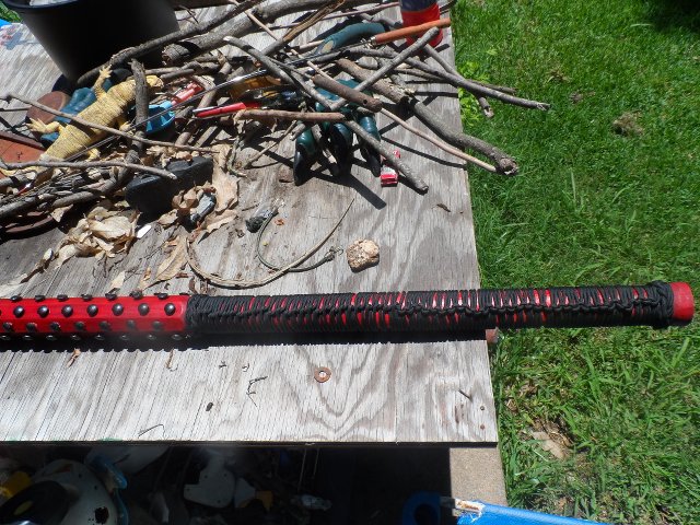

And...... finished....
I started off with a maple 3x3 and cut it down to a true 2x2 5 feet long.... 45ed the corners on the table saw to make an octagon.....hand sanded the 8 faces down then built a home made lathe out of a hand drill and a couple 2x4s to round out the handle....didn't have any lathe chisels so it was turned down with 60 grit, then 100 grit, then finish sanded with 400 grit.
After that I marked the hole locations and hand drilled them, stained the wood, then sealed it with tinted clear coat, did the paracord wrap and spent all day screwing in the carriage bolts....all 200 of em...
It weighs 8 pounds but swings faster than you'd think, balance is pretty good due to the 24 inch handle adding counter weight..... all in all, I'm pleased with the end result...a few little things I'd change if I were to do it again, but all in all, fun project, and looks good hanging on the wall. =o)
