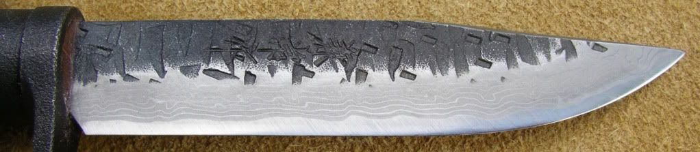

I just received a new, unused Kanetsune Urushi KB203 Fixed Blade.
Pic. shows sheath, knife, and paper blade wrapper.

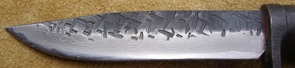

The blade steel is a 15 layer Damascus of Hitachi Blue Steel hardened to Rc61-62. Convex zero grind. hard to capture in pics, but here's the blade:
The convex grind appears to come to zero looking with 10x loupe. i.e. both grinds meet to make the edge.
Problem is, it is not sharp enough to shave arm hair. this surprises me because i have read posts by a few people stating that their Kats. arrived super sharp, hair poppin and beyond. there is no burr and i cannot see a wire edge.
I'm a beginner at sharpening and i have screwed up other new knives and ended up taking off way more steel than was needed before ending up with a so-so edge. I have never tried a convex grind but have a JRE Convex Sharpening kit ready to go.
I would like advice on best approach for this blade. maybe it won't take much, so try stropping first ? bare leather or with compound ?
then move up to a fine sandpaper with the JRE ? if so, how fine ?
does sharpie trick work here to see if i am maintaining the same radius of convexity ?
etc. i'll appreciate any experienced advice given.
thanks, roland
