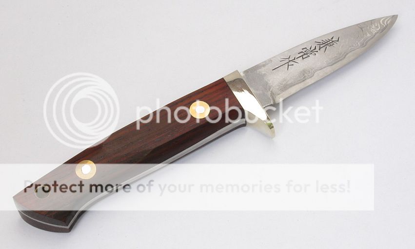

What kind of edges do Kanetsune knives have from the factory? I know that they are usually very sharp out of the box, but what kind of grind do they have? Approximate angles, flat/convex, etc.
Also, what carbon/stainless steels are roughly comparable to the white and blue paper steels that Kanetsune use? From what I've gathered, the white steel can take a keener edge, but dulls faster, but that's about all I know, and I don't know how big of a difference it is.

They have convex edges. Don't try to reprofile them as the steels are very hard and you may make them more prone to chipping if you thin it out.
They do come 'sharp', but I have found it necessary to strop them on leather to get them to the level of sharpness that I prefer (equal to a Scandi). This also removed the layer of clear lacquer the the blade was coated with to prevent rusting (all the Japanese non-chef knives I have purchased have been coated this way).
I got this Kanetsune knife around six months ago. IIRC, it's an exclusive model for A.G. Russell. They just call it the 7" Japanese Hunter.
The blade is blue steel and has a convex saber grind. It's flat on the sides, then about halfway down, there's a convex primary grind that goes all the way to the edge. There's no secondary edge bevel.
Yeah... Mine was sharp out of the box, but pretty thick behind the edge. I thinned it out a bit with DMT hones, then tried finishing with the Sharpmaker and a fine Norton India stone, but I kept getting micro-chips just from sharpening. I eventually put a thicker edge on it with Japanese water stones. It's held up well so far with no chipping, although it only sees light duty as a desk knife.
